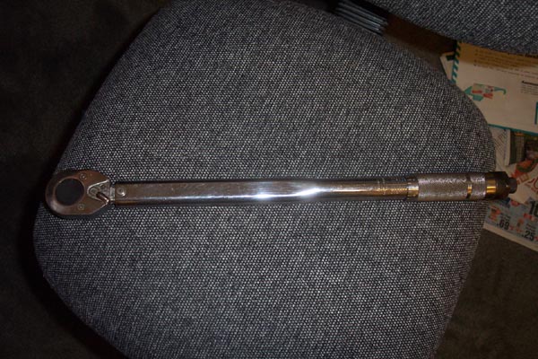

NO extension bar :eek: EVER for installing any kind of nut or bolt. Especially on a car. It's just not neccessary. Extensions are for removing the nuts( if neccessary). I have a very nice 1/2 inch drive torque wrench, also I have 6 sided impact drive sockets too (haven't used the impact wrench in years though, it's worn out). My wrench has a torque range of 10 to 150 ft-lbs . The 4runner manual states that the lug nuts should be tightened to a torque of 83 ft-lbs so that's what they got. It's accurate, calibrated every two years, since I don't use it often.
I don't know what a "torque stick" is. Never heard of it. Maybe you are trying to describe a beam-type torque wrnech?
Sorry John if that wasn't it then I have no idea why they warped. Maybe you just got a bad rotor?? Sounds like you know what you are doing so it wasn't pilot error. Hope it doesn't happen again. The torque sticks are extensions that can be used with a impact wrench, they are set to a maximum torque setting when they are made so a tech can use a impact wrench when they install your wheels with no fear of over torquing your wheels. Dealers use them to eliminate the potential pilot errors that could happen.
