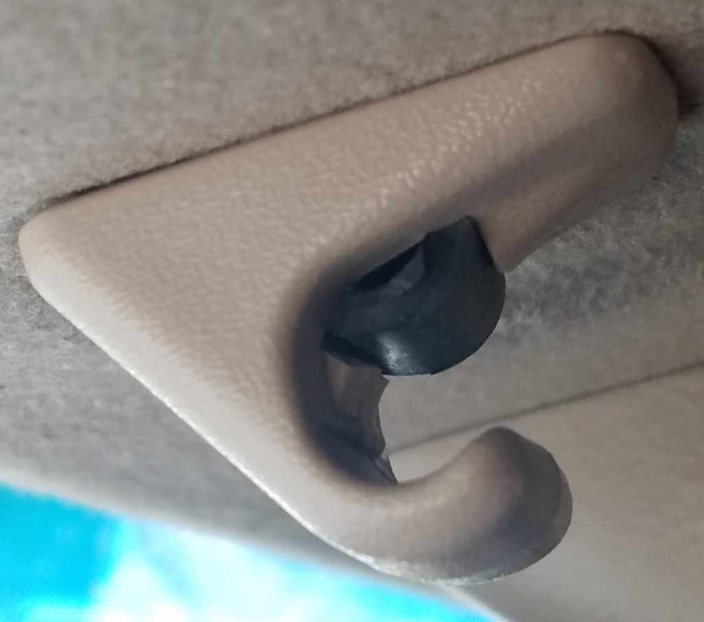

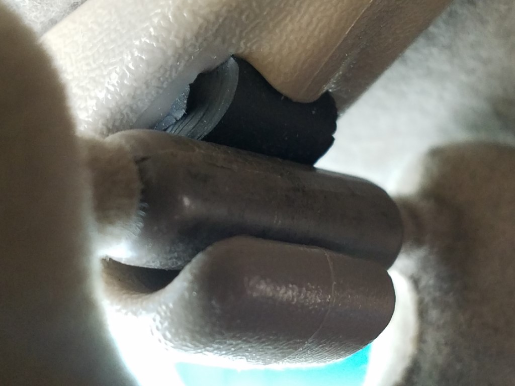

Does anyone know the part number and/or where to purchase a replacement clip for the sun visor? I'm referring to the clip that is attached to the roof that the secures the visor when it is folded up. My clip is still attached to the roof, but the tab(?) inside it has broken off so now the visor doesnt click into it.
I've looked through the diagrams on partznet and tried searching here and on google, but am not succeeding. TIA
Solution to Broken Sun Visor Retention Clip
I know this thread is old, but wanted to provide a solution to all those looking for replacement sun visor retention clips.
You can cut a shot 3/8" piece of rubber tubing (7/16" O.D. and 1/4" I.D.) and stuff it into the square hollow opening inside of the retention clip (remove it first and insert tubing from the underside, then re-install).
Works great. Very snug, and if the rubber dries out in a few years, its pennies to fix.
