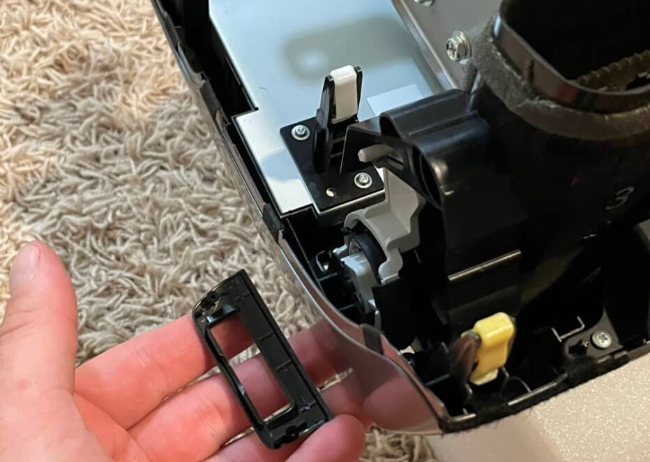

Hey all,
In my search I have been unable to find what part # is used for the white clips used for the head unit and side trim pieces on the center stack. The yellow clips appear to be part # 90467-10203 and when googling that number you do get white clips as part of the results but that seems incorrect. Has anyone here purchased the white variety of clips before and if so what part # did you end up using? I have attached a pic for reference.

Dude, thank you! You are a life saver. I had been up and down and just could not get lucky trying to locate the smaller white clips!
9046710201 - Clip - Genuine Toyota Part
Can be found on this diagram:
INSTRUMENT PANEL & GLOVE COMPARTMENT. 2016 toyota 4Runner | Toyota
Its part of a bunch of the panels, but in the upper right, it lists all the clips, and this is the 'natural', while you correctly got the other one on 10203, the pictures are definitely not straightforward!
Yup yup, oh and that link didnt go to the right image, from that second link, go to the second or thir image under "more images", and you'll see the "Natural", "Yellow", etc in the upper right
