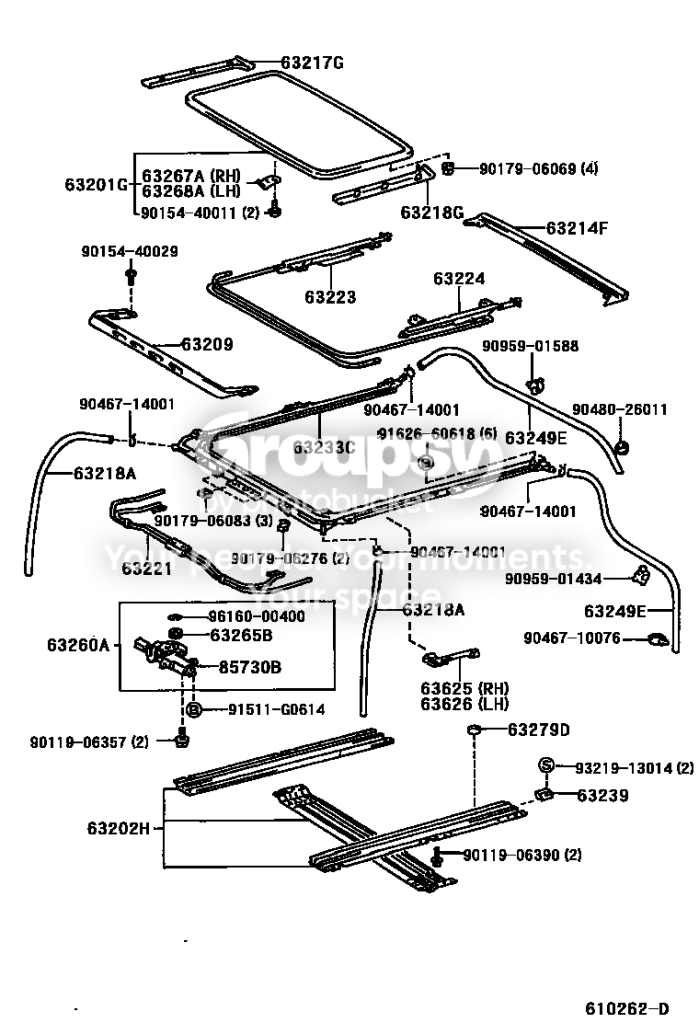

Here is a parts picture that shows where the two drains lines are located. I actually blew air up the rear drain lines (if you crawl under, you can see them). The rear drip tray or lack thereof may be the culprit. I think a new one lists for $125.
