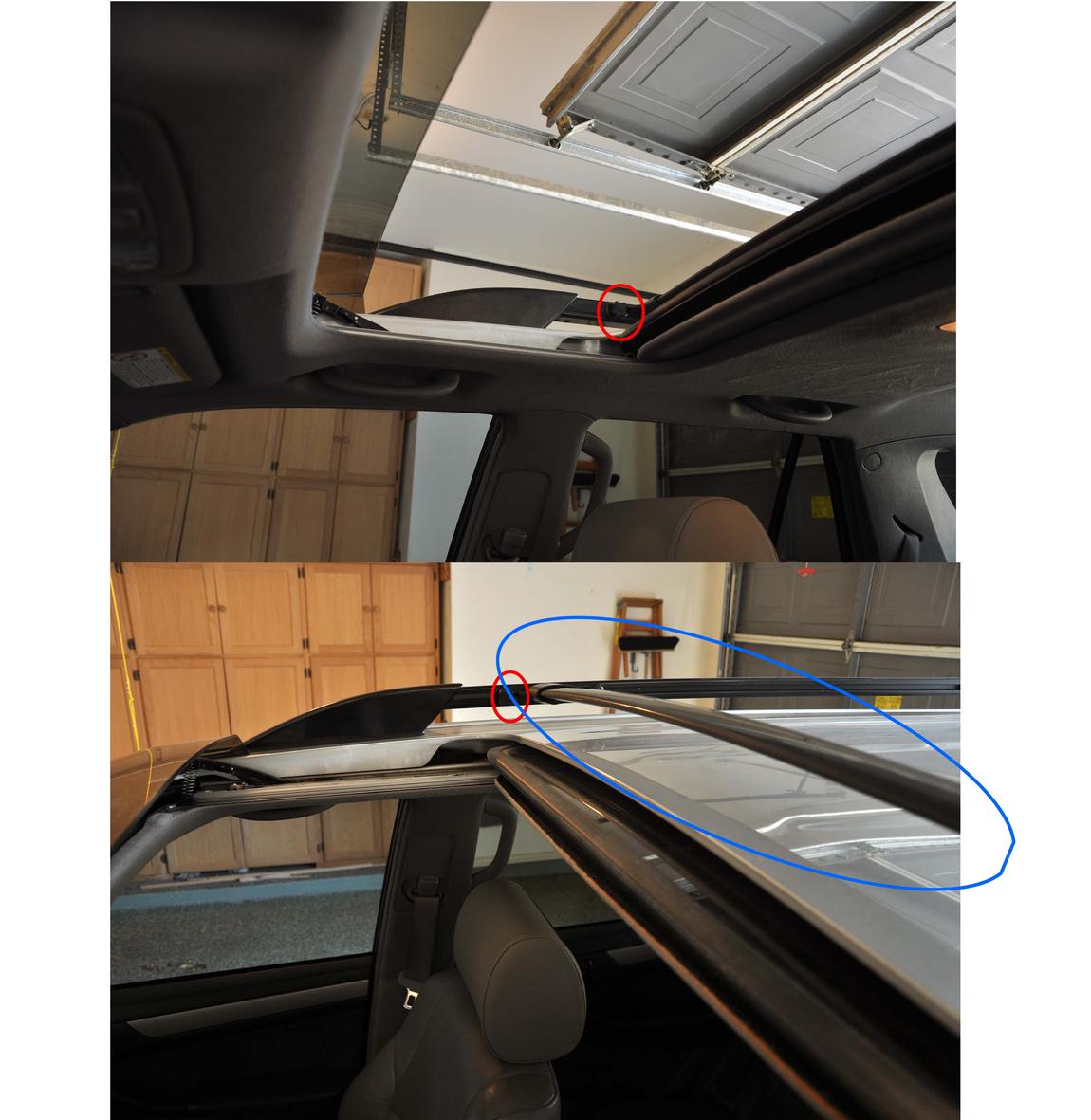

Can you post a pic where the knobs are, or what you tightened? Mine's rattling too!
OK i attached some pics. The top pic has a red circle of where the loose knob was. The bottom pic has a red circle where the knob is and a blue circle showing the cross bar that rattles when the knob is loose. After i tightened that knob the noise ceased! Hope this helps!

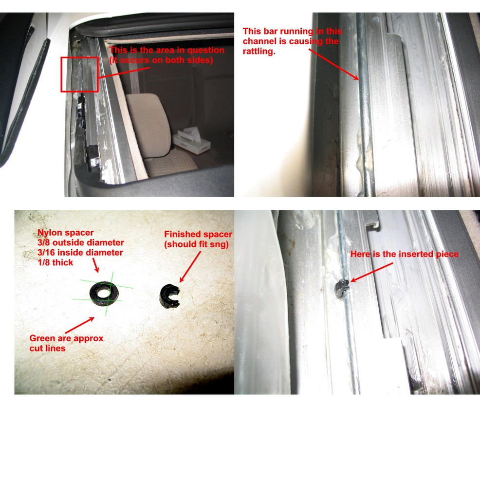

I had this issue on my 03 sport. There was a very effective fix on this forum which I used and never had the problem again.
I will try to explain.
If you slide sunroof open, there is a aluminum rod at the left rail (outside of it). this is what makes noise. This rod ruttles against the rail.
All you need is to find rubber washer (from tap repare kit) cut it open and slide over the rod to separate it from the rail. this is it.
If it is not clear enough, let me know. I will take pics of the area at sunroof. I do not have that runner anymore to post actual fix pics, but I have 07 with sunroof and I can picture relevant areas if you guys need it.

Hey Sonicpilz i took the pictures off that thread and re-saved them in photoshop as one file so hopefully this shows up. I believe this is what everyone is talking about (Securing this rod) I have a 04 and never had this problem yet (knock on wood) Ok here's the pics:
Thanks for the pictures!!! That sounds like exactly the spot over the driver's side. I've got a handfull of o rings I'm taking home with me after work this morning to try and get it fixed.
