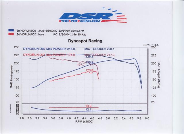

I havent' done any quater mile time runs but I'd like to just to see what time my rig can come up with, but I did have it dynoed-- I get between 213 RWHP to 220 RWHP so at the crank that would be much higher... Here is my dyno results---Before & after...

I know before I did my fuel mods-- I was running very lean-- I'm not too sure what my Air/fuel ratio should be -- The dyno technician did the adjustment to my fuel trim for I am not experience in doing this kind of tuning-- I took it was oK since they are the pro's in this kind of stuff... What should it be... any info is greatly appreciated...

14.7:1 is the perfect mix.

Gueez-- then I'm off-- all this time I thought I was OK-- need to go do some more fine tuning then... working with the FTC1 is a tricky thing-- I'll need some assistance again on this one...

The ideal target ratio is 13.5 to 14.7:1
Most tuners like to be on the safe side, so they keep it on the fat side, especially with power added. A lean condition could definitely ruin your day.

Whoa, I'm not sure I'd be tuning for 14.7:1 on a dyno with F/I. A/F's on the street are generally a bit leaner than on the dyno, so if you set it for 14.7:1 on the dyno, you'd be pretty damn lean on the street......
On any forced induction vehicle, I'd be shooting for 12.5:1.Seems the issue TRD had with the ecu was again, running lean!! I spoke to a tech who was familiar with the issue-seems the v8 would throw a rod on occassion with the lean condition and the supercharger-not something I'd want on a 40k limited!! I wish TRD would bite the bullet and sub the work out to get done and done correctly. Its been since 1997 with the old supercharger, and they still can't get it right.

The 14.7 : 1 ratio is for perfect conditions on a normally aspirated engine. You would have a hard time trying to keep that ratio at all rpm under variable conditions, which is why most tuners map on the richer side, to avoid a lean condition. If you have power added (turbo-supercharger, nitrous) you MUST tune it fat. I'm thinking that the ECU problem with the TRD V8 blower caused a lean condition and that's where some internal engine parts failed. The fix was probably to richen the map and avoid having to change hardware (higher fuel pump volume, larger injectors, etc).
