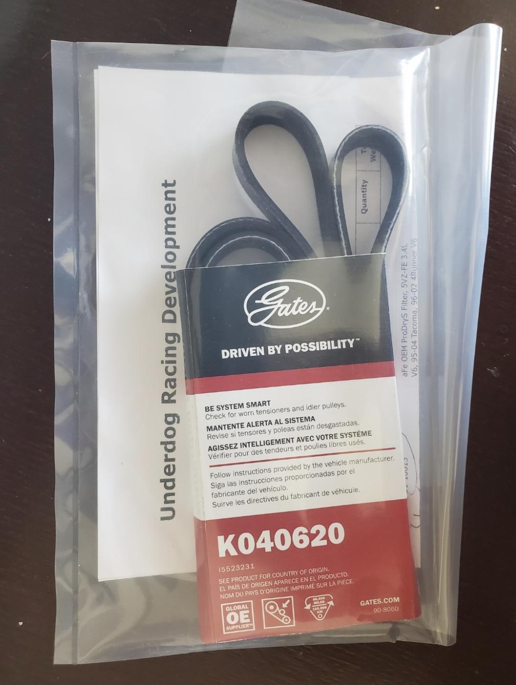

infamousRNR Senior Member May 5, 2023 #2 TRD 4RNR said: I'm not putting too many miles on my 4Runner these days - but it will be time to put a new Supercharger Belt on soon. Having trouble finding PTR30-35040 has it been discontinued? And if so, what is the recommended alternative? Thank you Click to expand... Yes, the belt has been discontinued - this is the option I know of. I hope others will chime in if there are other options out there. The original OEM belt WAS made by Dayco, which calls it a 610K4. The generic sizing is 4PK-1575 If you're in the Bay Area still, you should come to the sicmods BBQ in San Jose, CA on June 3rd - https://www.youtube.com/watch?v=sb9ZqFR7kdI&feature=youtu.be . Attachments IMG_0581.jpg 133.1 KB · Views: 809 Last edited: May 6, 2023

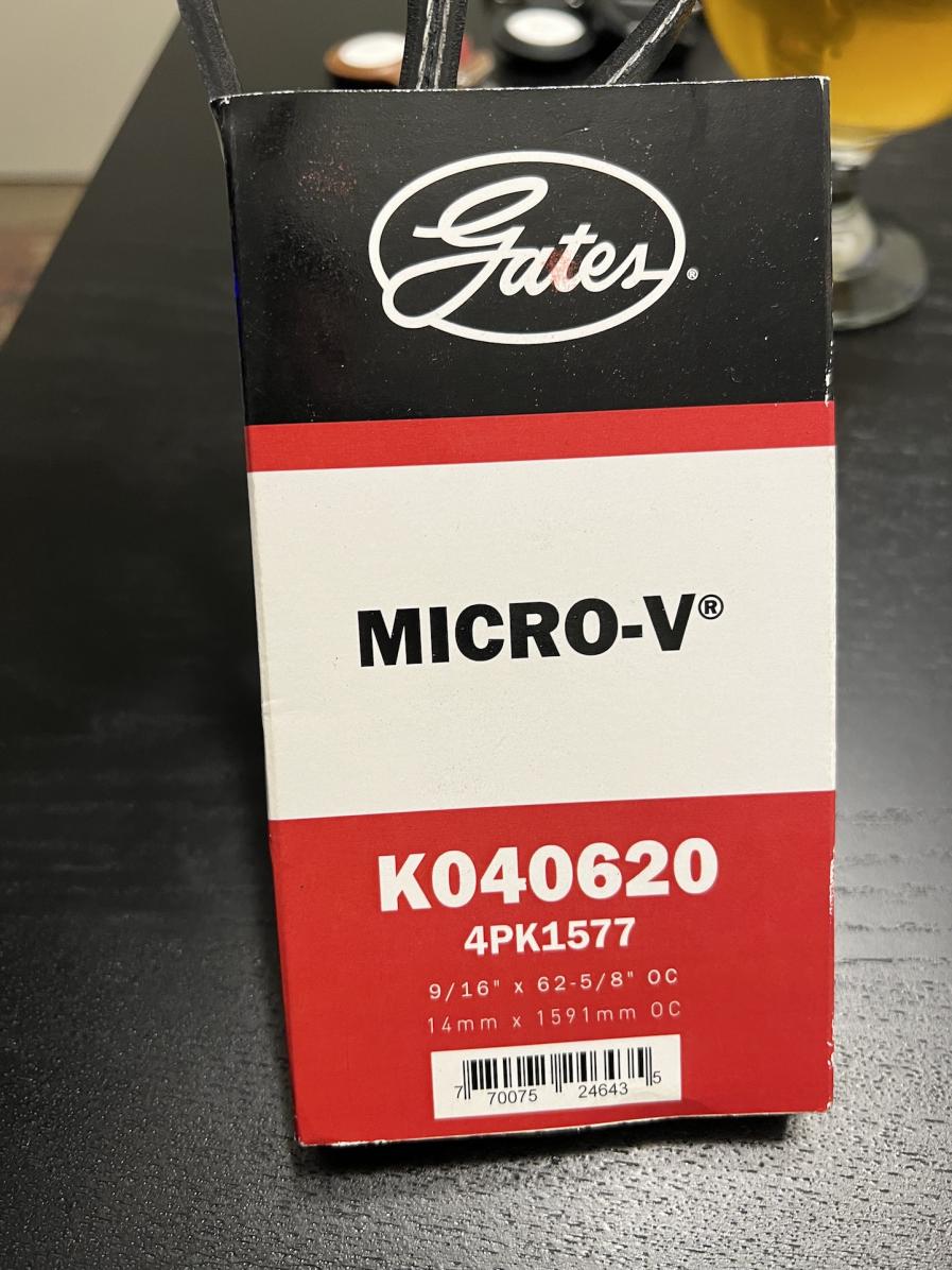

TRD 4RNR Member May 9, 2023 #3 Thanks for the reply and the info. It turns out I ordered one via URD and got this same belt. I'll try to make the event on June 3rd ! Attachments Screenshot_20230509_124927.jpg 119.8 KB · Views: 835
