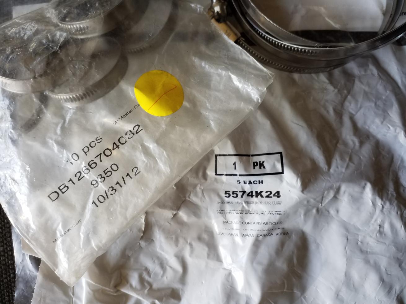

LOL....Next time you might want to consider buying these and using them instead of them OEM clamps that just loosen up on you.
