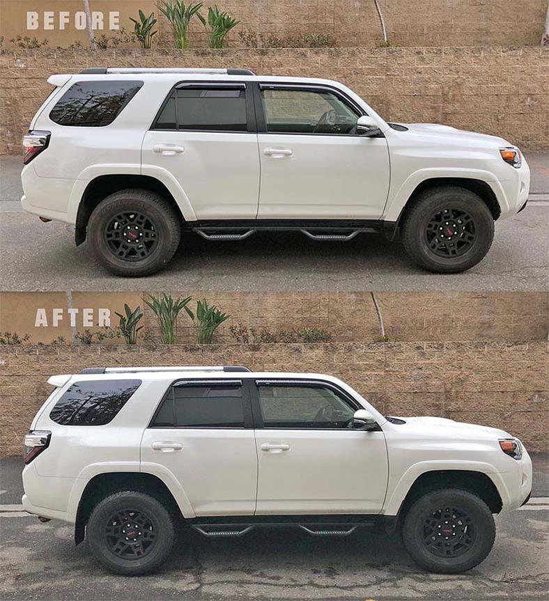

2" Supreme Leveling kit
I had the 2" Supreme leveling kit installed yesterday. What a awesome difference 2 pieces of 1" metal can do! Boosted the nose up at least 2 full inches. Looks way better I think. I don't have any real auto tools so I had my local mechanic do it for me. Parts on Amazon + Install + Alignment service = $424 all in.
