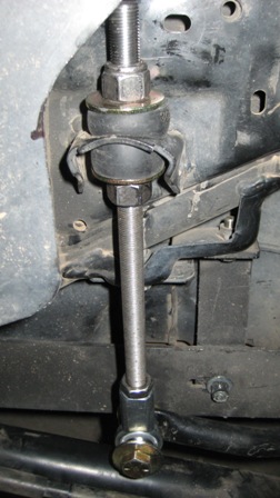

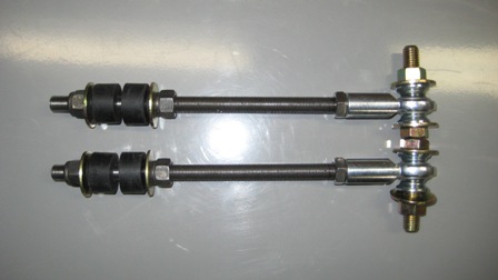

Extended end links for the rear sway bar like this one pearlj10 is selling.
http://www.toyota-4runner.org/5th-gen-t4rs/127648-heavy-duty-rear-sway-bar-links.html
Hi all,
I recently made a pair of rear end links for my heavily modified 4Runner, attempting to build upon the great aftermarket upgrades that are already offered. After running trails such as Elvis and Woodpecker in Arizona (YouTube them if you’re not familiar!), I am convinced that these are a superior product. I am offering these to fellow forum members only, if interested. These fit all 03+ 4Runners and 07+ FJ Cruisers, except for those 5th gen TEs that have the KDSS option. The main features of the sway bar links that I am offering:
  • Zinc plated, Teflon lined rod end for superior longevity
  • The unique feature of stainless steel misalignment spacers on both sides of rod end. In my experience this prevent premature wear of rod end from bolt and nut contacting rod end at full articulation
  • Beefy zinc plated threaded steel rod rated at 125,000 PSI tensile strength
  • New Energy Suspensions polyurethane bushings (I have tried thermoplastic and, in my opinion, these are too soft to hold up to many episodes of intense articulation). The supplied bushings are notched to carry additional lubricant. Much like Total Chaos UCA bushings, I have found that a waterproof and multi-purpose synthetic lubricant containing PTFE - such as Super Lube - prevents squeaking.
  • All new Grade 8 hardware
  • Available for 0-3” lifts, if you have more than 3" of rear lift I can build a custom set to meet your setup (please PM me if that is the case)
  • Simple installation with 19 mm wrench/socket.
  • Instructions for installation/proper bushing deflection are provided
Also note the comparison picture showing the anemic stock links, and these stout, extended length links.
