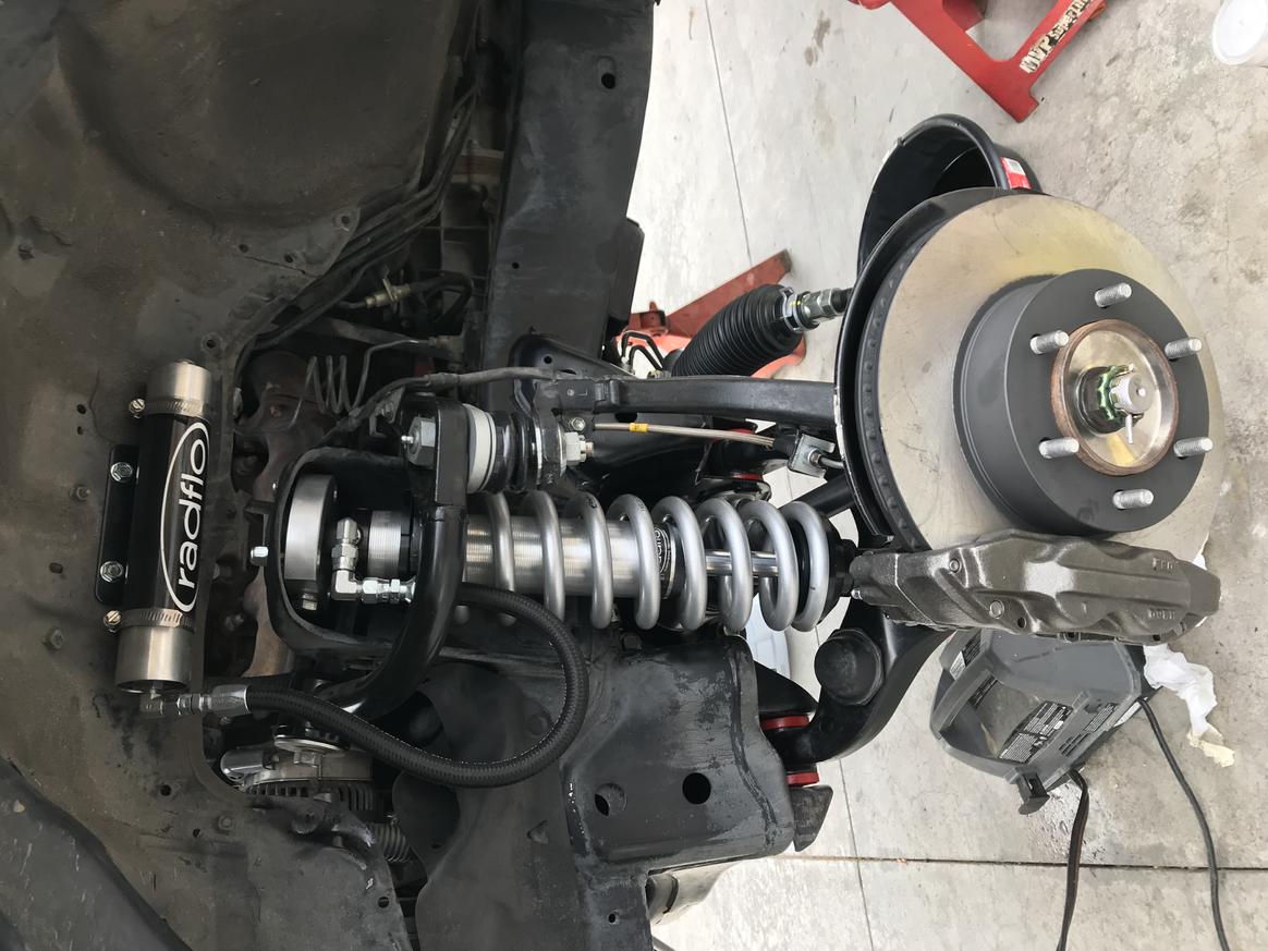

Having saved up for a good, full, suspension system from Sonoran Steel, I would HIGHLY recommend you consider doing the same. Steve is a wealth of knowledge on 3rd gens, and he will set you up with the perfect combo of parts for your particular truck.
I went with 2.5" remote resi Radflo's, and could not be happier. They eat up rough/washboard roads and are very nice on-road too.
I am now convinced money you put into your suspension system is money very well spent!
