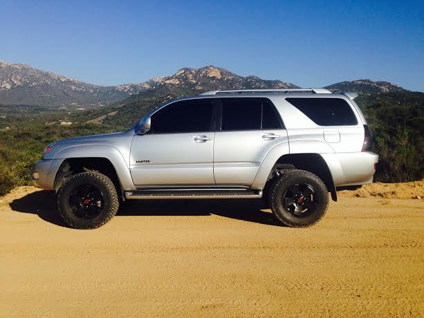

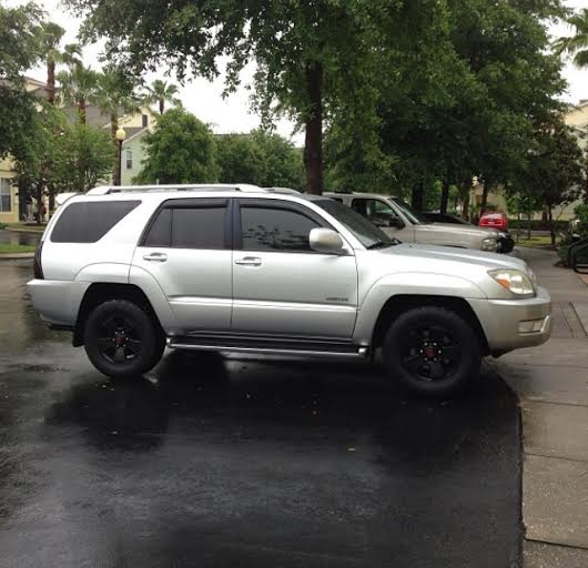

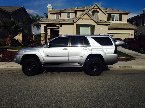

What difference new suspension makes! To recap I got OME 884 1" coils and 5100's set at .85 and OME 885 2" 5100's rear. Wheels stock 17" with 265/65 Nitto's that will be replaced with BFG TA's 275/70/17. The lift is taller and much better than I had expected. After doing this lift, I'm trying to figure out why people mess around with spacers and daystar lifts. Not a critic, just wondering because the cost to do this lift was relatively inexpensive. I need to take some better pictures than what I have taken and get on some level concrete to take measurements. Needless to say, it turned out way better than I thought it would. The ride is stiff but plush.

I need to fix the links to pics. The rear is great. Not harsh at all. Just firm.
Looks great man, thanks for fixing the pics. This is the first thing I looked for this morning.
I also have wondered why people go with spacer lifts if it can just be done with the right spring. Thanks for sharing!
Thanks JB. The only thing I am considering is putting airbags in the rear springs for towing to keep the Runner level and not nose high. I still need to take measurements to see here the front and rear sits. I wanted level but under load it will be nose high.
