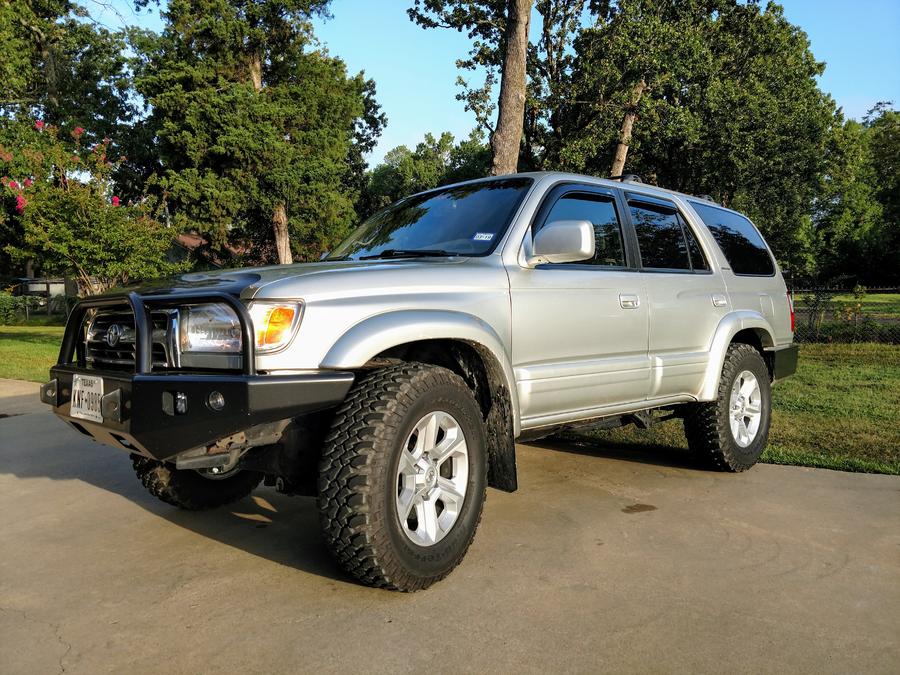

This is my 2000 4Runner. I'm looking for advice on a suspension lift.
My goals are to gain more clearance for my 255/75/17 tires when I am using it at my hunting lease. I don't plan on going any bigger on the tire size.
This is my daily driver when I don't have to pull something with my 3/4 ton for work or play, so ride quality is extremely important to me.
Current set-up.
for DD, i'd suggest only lift enough to gain the additional clearance you are looking for. 2" lift you can do suspension only and not unravel other required mods.
"so ride quality is extremely important to me" - I put in the Bilstein 6112 up front. Ride is like a magic carpet. In back, the OME 906 seems to be the go-to for 2" and it matches the 6112 very well. At first I thought they were too stiff, but after a couple months everything settled and it's worked awesome for my DD.
Good luck and have fun.

Are you on stock shocks in the rear?
As far as ride quality goes get Kings. I had 6112's and switched, it was a night and day difference. Not saying anything negative about the 6112's, but they just don't compare. The Kings are much smoother on an off road.
