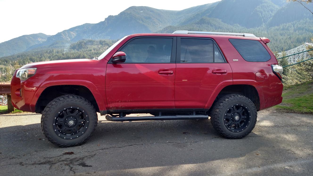

Honestly, at that point you would be better off just doing the 5100s @ 2.5 and doing a 1.5 spacer out back. It rides fine and looks great. I even took out the front sway bar, and that makes the front WAY smoother (let's front corners be "independent"), but has a little more body roll. Here is my 2014 with that setup:
