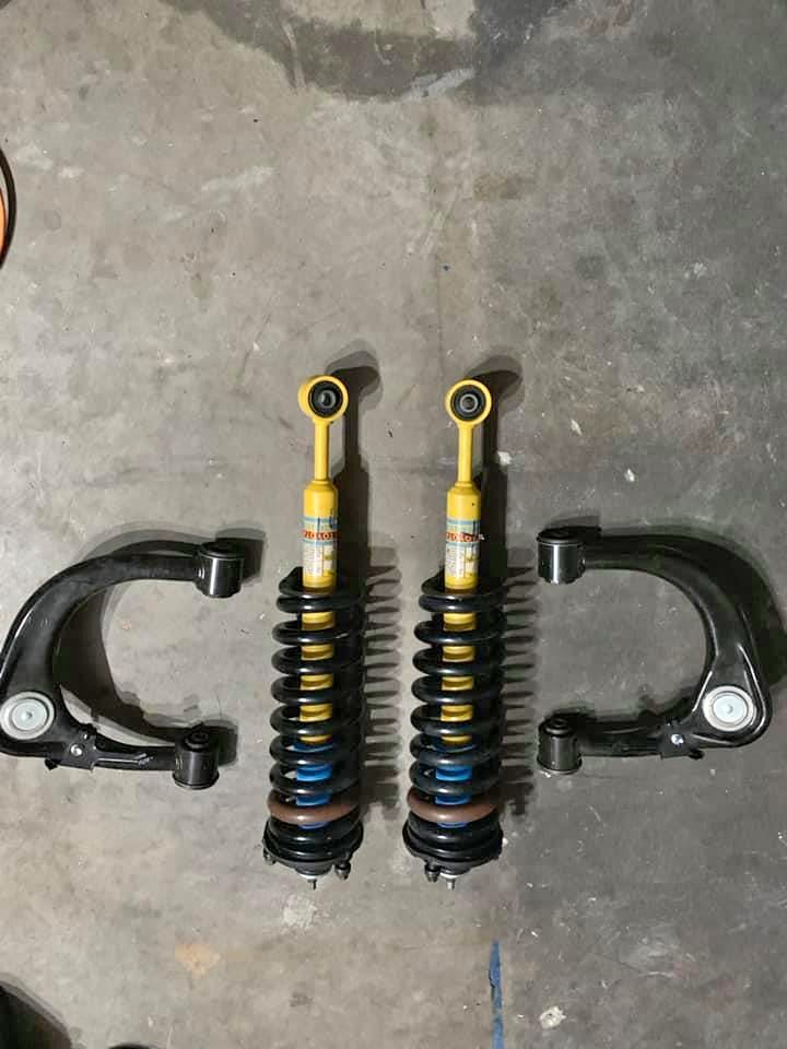

No remote res, so just misinformation on my part LOL, but coilover assembly and UCA's for $150. The ad reads "2019 Tacoma TRD Off-road front coils and upper control arms. 500 miles on everything."

Unfortunately they got sold before I was able to make the few hours drive to get them, so I am back looking again.:frusty:

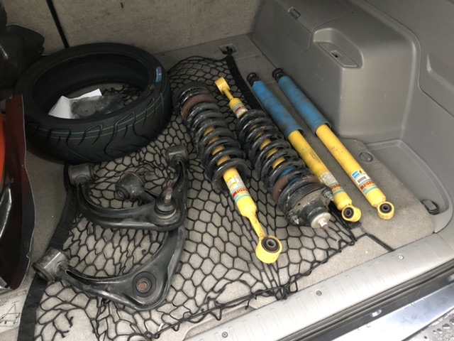

Did you ever get around to installing the 3rd gen fronts? I finally was able to put a deal together, so am going this week to pick up 3rd gen 2016 TRD Tacoma front coils, all 4 Bilstein shocks and UCA's that were taken off with 12k miles. I figure about 2-2.5" lift on the front of my V6 2wd, maybe more since the front is sagging a good amount as it is. I'm thinking of just doing the front first so I can see how much I want/need to lift the rear for the slight rake I want and then order springs accordingly. Any tips or thoughts on that plan that I may have missed in looking through all of these threads LOL?

Finally made the 4 hour round trip drive today and got the setup from a 2016 TRD OR4x4 with only 12k miles, and dude’s truck was nicely kept so I have no worries about these...$150 well spent I’d say! Hopefully thanksgiving weekend will give me time to at least do the fronts and see what springs I want to get for the rear.

No, the rear is not soft. This setup has been golden on and off the pavement for 21 months & 41K miles since I went that route. Anything on my YT channel (linked in my sig) after Dec 2018 is on the Tacoma/FJ setup if you’d like some video evidence.
