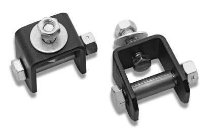

You should be fine with your stock springs up front. When you assemble the struts just put the front perch on the top notch. The shock adapters are like the ones in the picture. The guys at downsouth I hear are pretty reasonable, you should call them and let them know you're buyingthe kit for a 4runner and maybe they can switch the shocks out for the correct fit for the 4runner just maybe ShockMountConvers161.jpg.
