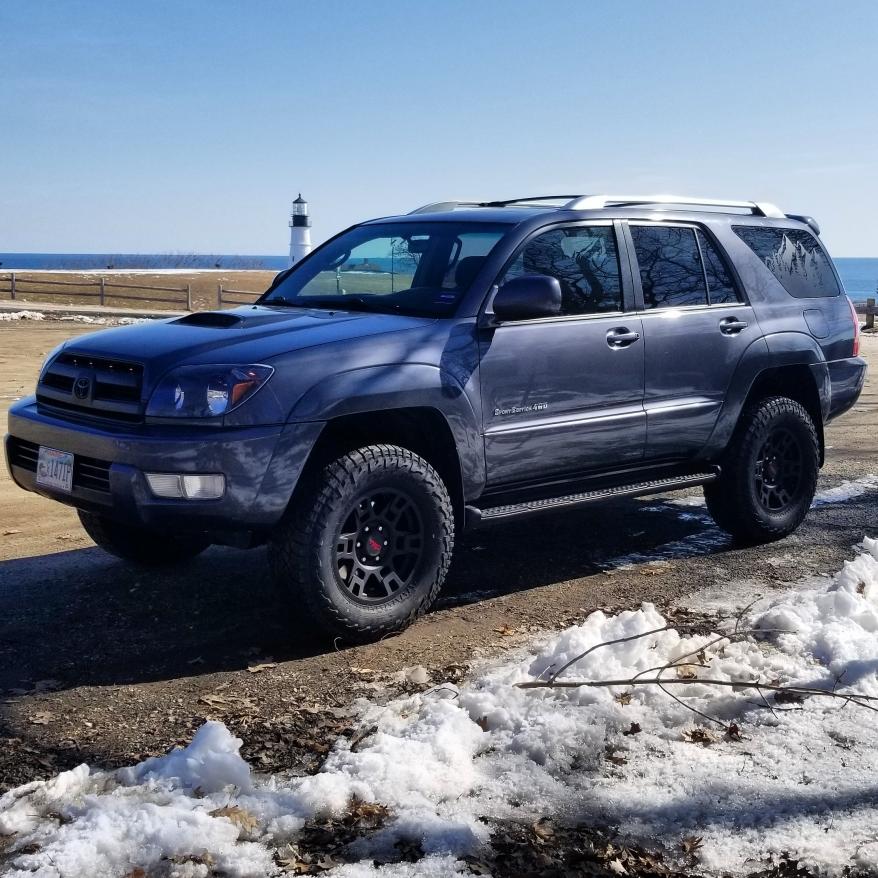

Check out the “X-REAS delete...” post linked in my sig. The setup I ended up with is affordable and rocks both on and off the pavement. Not suggesting the same exact gear necessarily, just the same approach.
I am very happy with my setup
Front Struts: Bilstein 5100 (lowest perch setting)
Front Springs: Toytec (eibach) 2.5" spring
Rear Shocks: Bilstein 5100
Rear spring: stock spring with Daystar 2" lift spacer
Parts sourced from Amazon : shocks abd struts as a kit for $369. Daystar spacer kit $80
Parts sources from toytec.com springs $169
Also needed front upper strut mounts sourced locally for $29/ea
