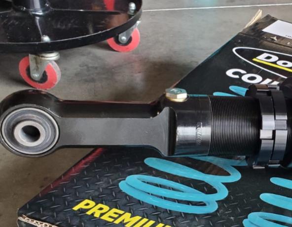

Forgive me if my eye deceive me, but it looks like the Dobinson's have a lil nipple dude on the rear shock so you could add a resi later on.. anyone else see what I'm talking about?
I've never ran resi shocks so I'm kinda taking a shot in the dark here, but I figured if that was the case, it was worth pointing out

Those are actually the old style valves in the photos of the rear shocks. They have a flat valve now. That's just to add pressure for the internal reservoir inside there. If it was an MRA with resi, it wouldn't have the internal resi and that's where the hose would attach to go out to the resi with the floating piston inside it.
Here's a photo of how the valve actually looks.
