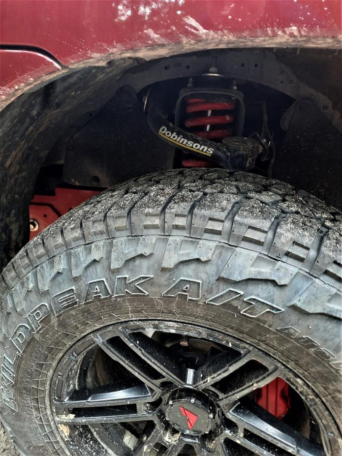

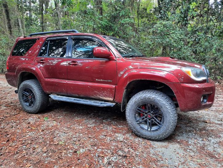

I went with a Dobinsons IMS set up and truly enjoy it. Excellent ride on and
offroad, great quality and built for what you are looking for. I put Dobinsons C59-302 front springs and C59-505 rear springs. That gives a 2-2.5 front lift and a 1 inch rear lift, so just a little lift. I went through Exit Offroad and spoke with Mike. He really explained the different qualities (IMS mono tube vs twin tube) and was great in helping me choose a set up for exactly what ride and offroad qualities I was looking for.

This sounds like something I’d be very interested in. Do you have pictures of it installed on your rig?
pics
Pics of the mentioned Dobinsons set up
