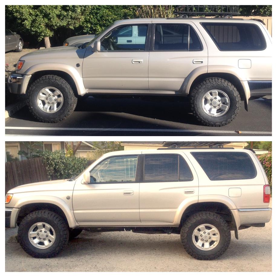

Just finished mine and the ride is much better...smoother, better on bumps. This is stock with 265/75/16 on top and below is OME 881/890. The shocks are Rancho 5000's. Minus the tires, should be close to your budget.
Thanks for the input bro. I really like that height, it looks really good. I think I may take the plunge and go up 3. I just don't look forward to the diff drop (must at 2, so I read), I've never done it before. Edit: Did you get the spacers on the 881s?
Diff drop is optional, but recommended. Your cvs will be fine without a drop.
