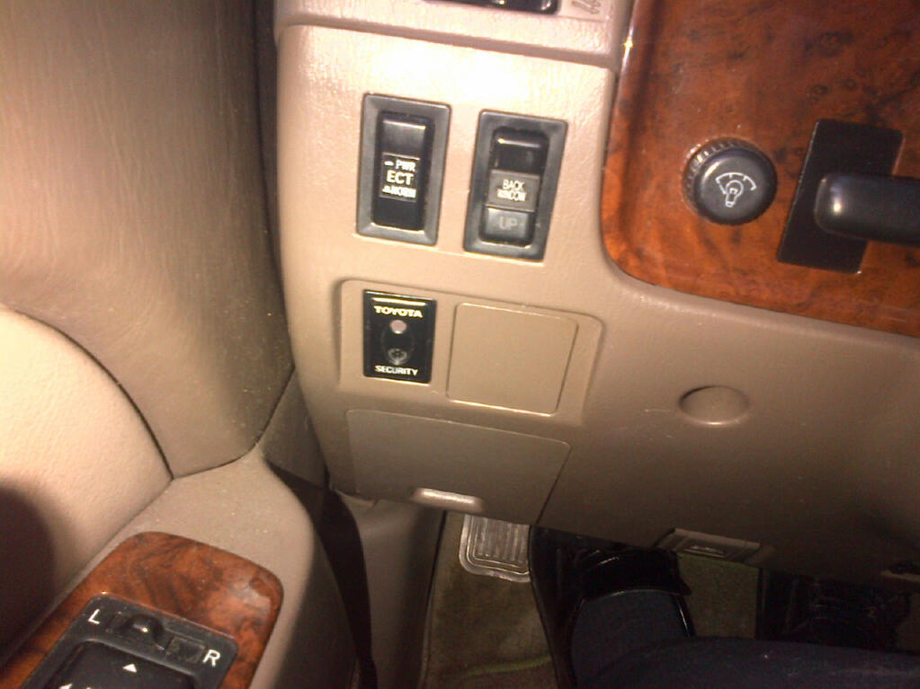

The security blinking light, ECT switch and rear window switch will all have to move from the parking brake cowl to up above the AC Control. Also I'm going to try and see if I can supply power to the 2 additional 12 volt outlets. I doubt it.

Finished last night - easy job - only weird thing is rear window switch is illogical when it is facing you (up is on the bottom).

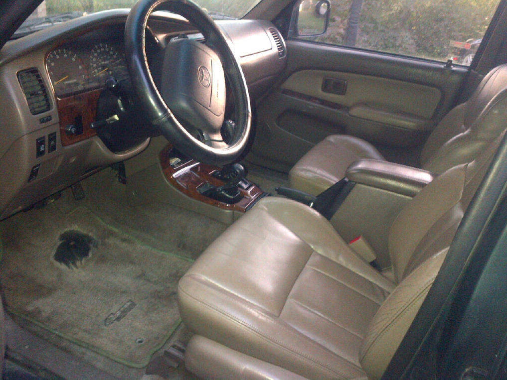

Before and after

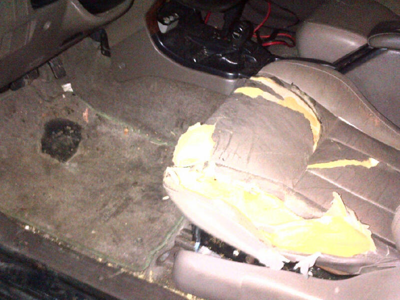

I also swapped the seats in addition to the center console - before and after:
