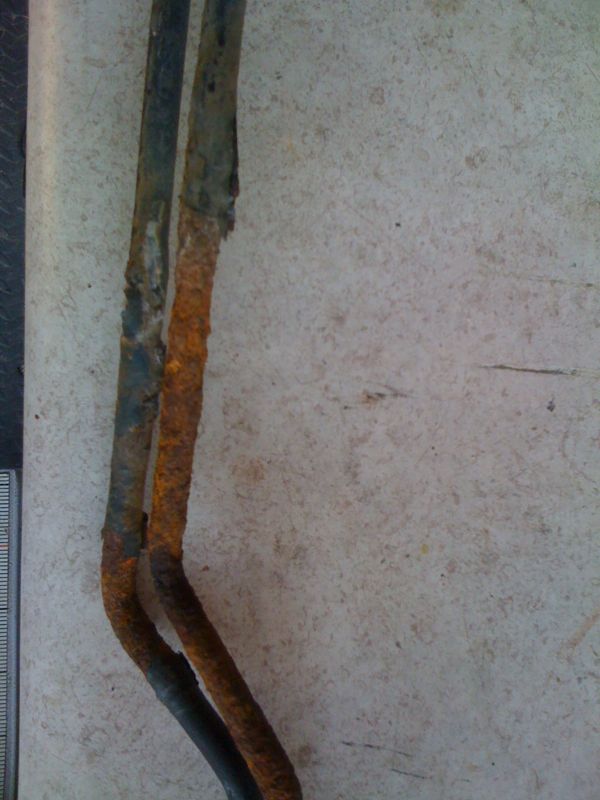

Today I changed the radiator (Koyo A1998), thermostat (Stant) and gasket, cap, and rear heater lines (OEM steel). Everything went pretty well. I was really worried about how the rear heater lines would come out (and go back in), since they are about 4 feet long, and bend in all sorts of funny directions. The old ones were rusted badly, and it was only a matter of time before they sprung a leak and left me stranded. If the new ones last 10+ years, it will be $70 well spent.

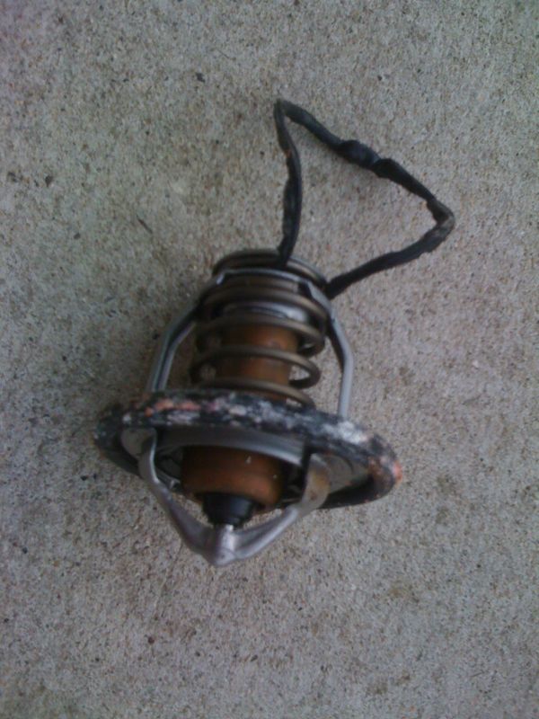

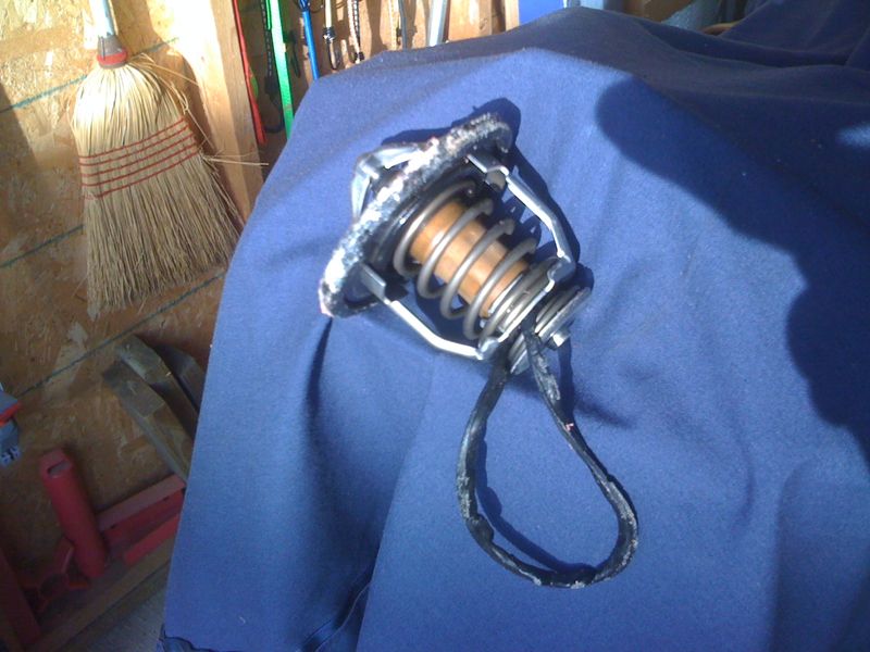

Now, for the past year or so (even through the cold-ass winter), I've seen water temps above 200F on my scangauge II. I've been concerned about this for a long time, since when I first got the truck, it would never get hotter than about 188F. I had no idea what changed, but it certainly has been running about 20 degrees hotter than what I would consider "normal".
So, I worked on getting the t-stat housing off, being very careful not to shear off those studs. 1 of the 3 nuts came off, the other two brought the studs with them, but nothing broke! When I removed the old, crusty t-stat, it was pretty apparent what was going on. Whoever replaced the t-stat last was not careful to remove some black RTV sealant someone had put around the housing surface. Believe it or not, there was a ring of RTV jammed into the smaller spring of the t-stat, probably preventing it from opening all the way. Luckily for me, this ring didn't make it's way further into the block! Anyway, I removed the old stat, and cleaned the housing and mating surfaces very well. There is no need for RTV here, if everything is clean and a new gasket is used. Which, of course, is what I did.
Everything went back together as planned, including the rear heat lines. For these, it helped to remove the top half of the transmission dipstick tube. For the coolant, I mixed 50/50 Toyota super long lasting with distilled water, and used the Lisle coolant filler funnel (I tell ya, that thing is WELL worth the $25!). The system took 2 gallons of the mix, and left me with just enough to get the reservoir up to the proper level.
The best part - after a test drive, I couldn't get the water temp above 188F!!!
Friggin' amazing. I'm so glad this worked to get my temps back to normal. Now I'm sorry I didn't do it sooner!
So what happened? I think that ring of RTV was keeping the stat from opening fully, slowing the movement of coolant down enough to raise temps 20 degrees.

So replacing the rear lines was a straight forward deal?
Mostly. Here's what I did.
1. Drain coolant
2. Remove the 3 nuts holding the lines to the body. One at the very rear by the rubber lines, one about a foot forward from there, and the last one very near the exhaust downpipe.
3. Disconnect steel lines from rubber lines at the firewall and at the point where the lines enter the cab under the passenger seat. These are just spring clamps. Some coolant will come out from the rear connections.
4. Remove the bolt holding the upper half of the transmission fluid distick tube to the block. Remove the dipstick, then the upper half of the tube.
5. Pull the lines off the 3 body studs that the nuts were on, so the whole assembly is now "loose".
6. Wrangle the lines between the coiled brake line near the passenger fender and the exhaust header, moving them slightly down and forward. You need to get the lines under the main wire harness that enters through the firewall (inside that corrugated rubber tubing). Some light flexing of the lines is necessary.
7. Pull the assembly forward enough to get the back end of the lines in front of the chassis crossmember.
8. Once the ends of the lines are past the crossmember, you can then begin pulling the assembly out the bottom.
9. You'll need to be on your back under the truck, carefully pulling the assembly out the bottom, turning as necessary to avoid hitting things. In the end, the lines came out between the exhaust downpipe and the steering rack.
10. Insert the new tubes in the reverse order! :-)
I moved from under the truck to the engine bay about 12 times doing this...just to be sure I wasn't snagged on anything like the catalytic converter. Have a piece of cardboard or a creeper handy.
