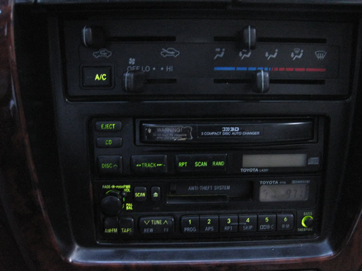

this is my current radio
prhime said:
no to both. from what i have found you can swap in the same generation once you match the pin count.
It is most unlikely that your present setup has the 20 pin plug shown on the rear of the Ebay unit. In addition the JBL units usually need the matching JBL amplifier and there may be other missing components of the JBL system. This unit may also have problems fitting through your dash.
there is a non-JBL that is also 20-pin. I'll try to either find more info on my unit online or pull it to see the back
Sounds like a good first step. You may find that the display in your present unit uses replaceable lamps.
from the research i've found. the illumination is a bulb that can be soldered back once the replacement is found (not a general carry in most stores it seems).
the bulb is part of the problem as the CD changer works sometimes. Other times it works then if i turn off the car and restart it doesn't play anymore.
It's too bad that's a great looking radio.
it had a solid run and the light went out (after the tap back to life went out as well) before i got the 4runner so it was something i was determined to fix in some manner.
