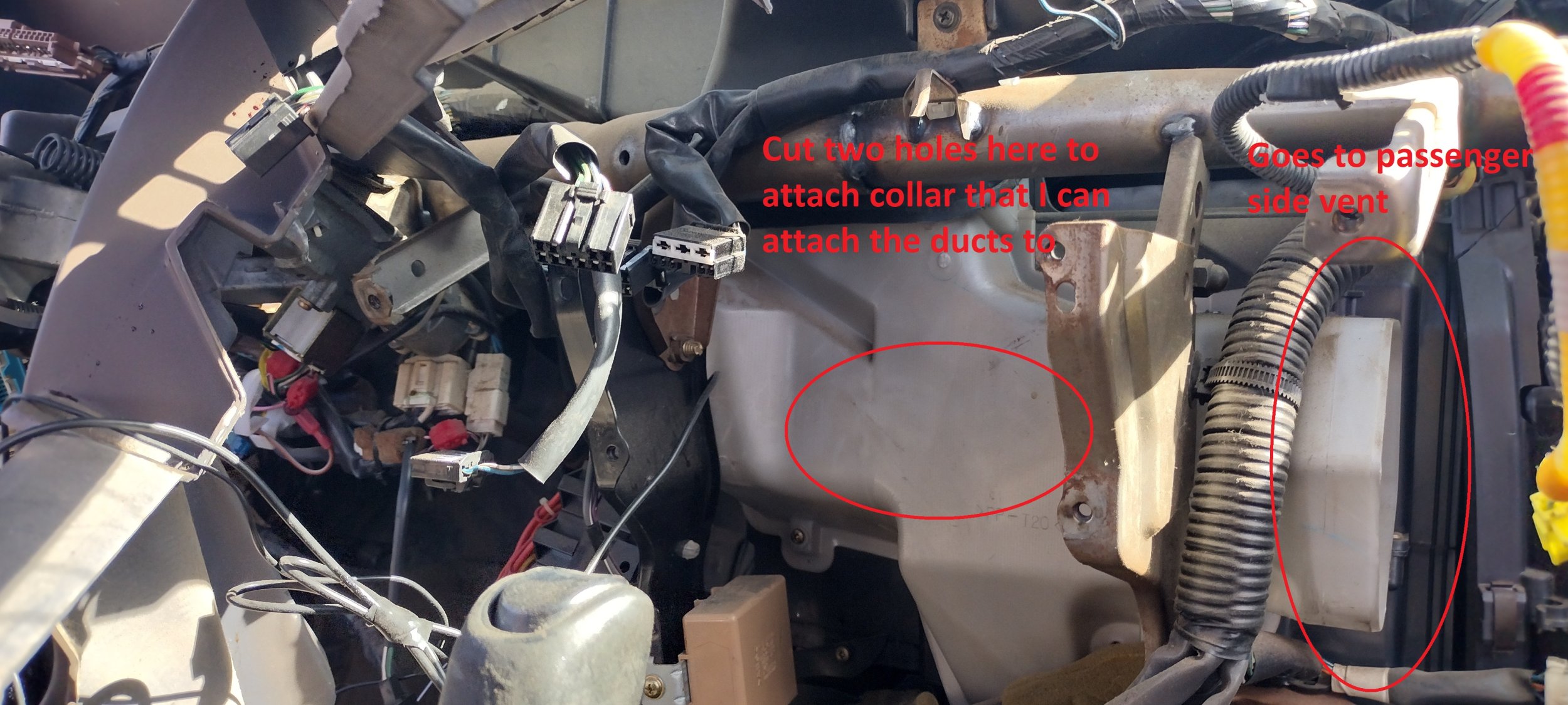

So this looks very doable, as you can see in this picture the white piece I'm almost sure is downstream of the controls that send air to the front, feet or window defrost given that the duct that goes to the passenger side vent is coming off of here.
img_20230311_150016209_hdr-jpg.112800
Pretty sure this was a limited with the electronic controls but I doubt things would be in a totally different spot here with regards to whether this is downstream of the controls.

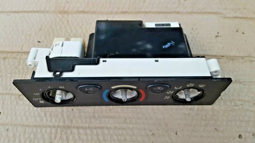

That's not it, the one I'm talking about took the HVAC controls and swapped locations with the radio, putting them just by the shifter then had some kind of filler for the size difference. If I ever come across it again I will put the link in here, but that may be a long time
it looked something like this, but with the analog slider controls rather than the digital ones, I also remembering it having blue leds for the backlight

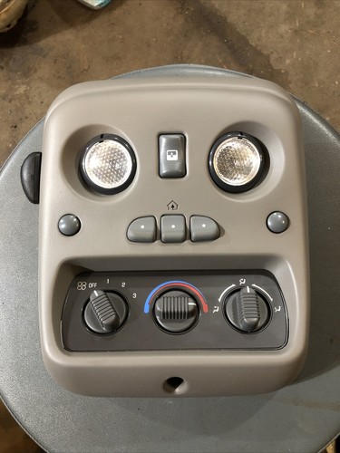

personally, if I had the digital controls like this picture did, I'd get one of these overhead controls from a 99-02 suburban:
If someone manages to put this in, I'd love to see it
In theory, everything could fit and you could use the stock 4runner controls and just relocate them up there, taking place of those suburban ones. I'd look more into it but I have a 98 without the slimmer digital controls.

It would be a lot more possible to do with digital controls. I’m 99 percent sure that the analog controls in 96-00 are cable actuated so that limits how far you can relocate the controls.
