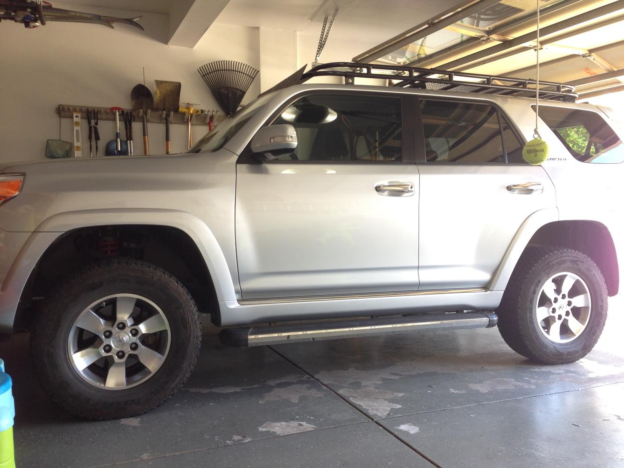

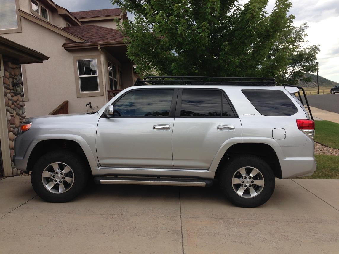

Have not had any issues, they've been in for about 4 months and I've done some decent off-roading. The ride really is great, but I came from the Xreas setup so probably different then you, my on road ride was already great. Also I did get exactly 1.5" in lift in the rear, I have third row seats which apparently does seem to make a difference. I have 265's and they might look a little small even for this setup, I'll probably go to dura tracks next but stay at 265.
Do you have any pics of your truck with the lift....
Hope these come through, the driveway is not level. Also see [MENTION=65614]Antman[/MENTION] build thread as Jeff has the same height lift as I do but with Duratrac's, his truck was most of my inspiration and it looks better with the more aggressive 265's imho.

Thanks jhalko! That is pretty much spot on the amount of lift i am looking for. I think the 265's look great on your truck! A little more width and offset on the wheels and some shoulder tread on the tires will give it a more agressive look for sure and should match up with my trail great. I have been talking with kevin at toytec and he has been really patient with all my questions. Think im about ready to pull the trigger and have it waiting when my runner finally gets here.
