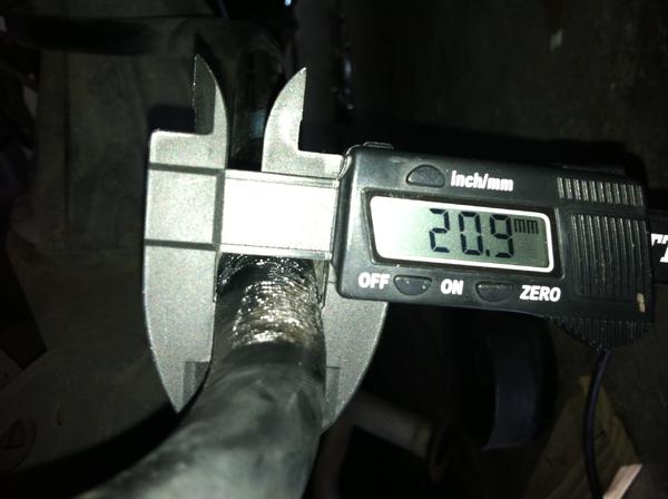

Please make note, the front sway bar diameter is 29mm (which seems to be standard of ALL '03-'09 T4R's), but the rear sway bar diameter varies (which is very important if you are going to change the rear sway bar bushings). Before purchasing your rear bushings (assuming that you are going to change out the rears), you HAVE TO put a micrometer on the rear bar and measure the diameter as it could range anywhere from 17mm up to 21mm, so you need to be sure.
