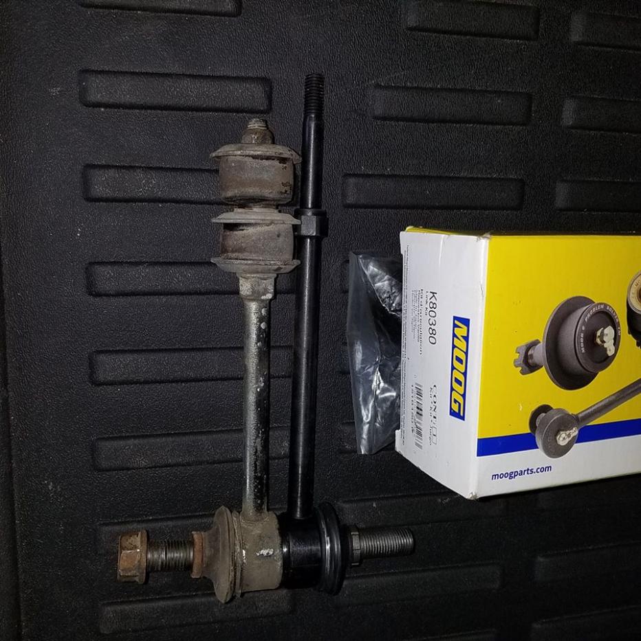

Can't help with the front but the rear can be done nice and cheap. OEM rear 3rd gen links are a direct swap and they're longer. I run them under the back of mine with my 2" lift.
