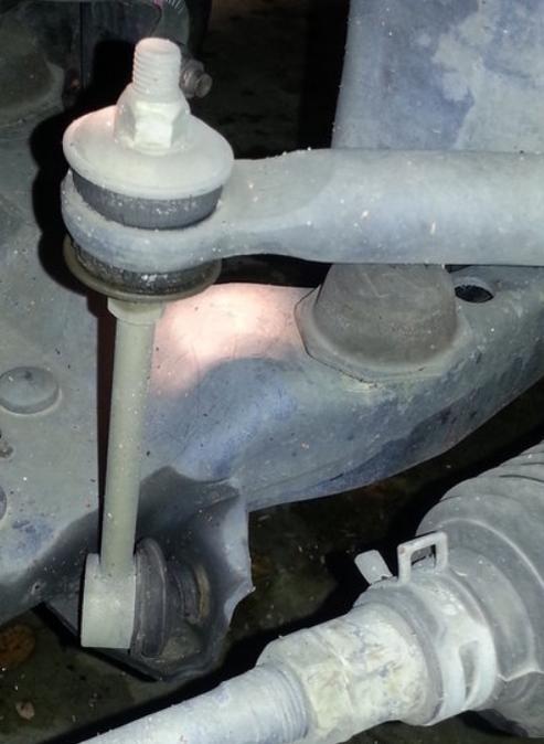

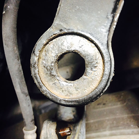

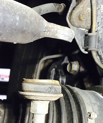

I have been doing maintenance on the truck since I got it. A few weeks ago I ordered sway bar end links. Decided to change them today and found they had broken. It happened recently, I am always crawling around under there and just saw it today. My truck lived in Indianapolis for for 14+ years so it has some rust. Nothing like some of the disasters we see on here though.

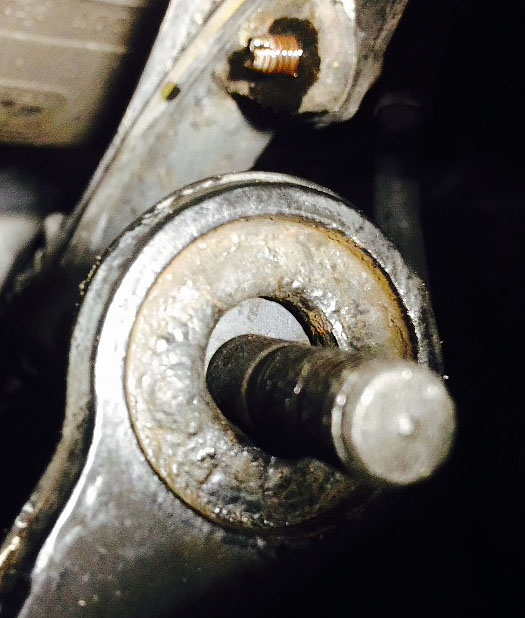

I put one of the studs through the sway bar holes to show the slop.
I assume I need a new sway bar?

When you tighten down the bushings, there won't be any play. You're fine!
To add onto this, don't tighten down too hard. Sway bar links only need to be tighten down till about 2 threads are above the nut. If you want strong endlinks that last, I would consider hitting up [MENTION=98153]MStudt[/MENTION] for a set of beefier ones.

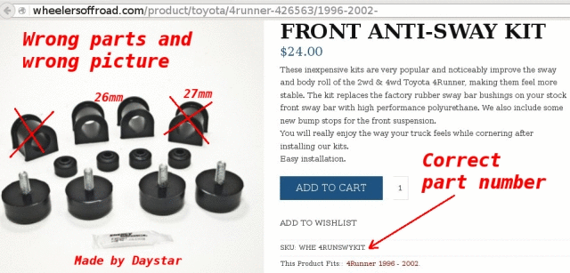

To follow up on your suggestion, as soon as I saw your post, I immediately called Dan at wheelersoffroad at 541-474-2879.
Dan was very helpful, and he explained that the picture is actually wrong on that web page you noted, but the part number is correct.
He said that picture is for the Tacoma parts kit (95-2000 TAC SWYKIT & 01-04 TAC SWYKIT) where they ship BOTH the 26mm and 27mm swaybar body bushings to the customers (who may require either the 26mm or 27mm swaybar body bushings - but not both).
The Toyota kit comes with two body bushings (not four), in addition to four endlink bushings, 4 bump stops, and silicone grease.
The Wheelers Offroad part number for the 4Runner kit is WHE 4RUNSWYKIT, but it only comes with the two 26mm swaybar body bushings.
I gave Dan all my conflicting information from Prothane and Energy Suspension, in addition to my own personal measurements of 26.5mm OD and 10.0 mm OD respectively for the sway bar and endlink midpoint diameters (which correspond perfectly to the 0.5mm preload on the 26mm ID Prothane body bushings and to the 9.5mm ID 0.5mm preload on the Energy Suspension endlink bushings).
Dan didn't think the preload was all that important, but he did mention that both Prothane and Energy Suspension specialize in chassis bushings, whereas his supplier, Daystar doesn't specialize in that area.
Nonetheless, despite the picture being wrong, Dan says he hasn't heard reports of his kit being the wrong size (which we know to be the case with both the typical Prothane and Energy Suspension kits).
Dan kindly said he will measure the ID of his bushings and he will let me know his results. I'm expecting 9.5mm (0.375 inches, or 3/8-inch) which would give us the 20 thousandths (1/2-mm) preload that I would expect, in addition to the height preload.
So that all the relevant information is in one spot, I will update the current thread with any updates that Dan provides me.

Online retailers often use a "stock" photo for multiple part numbers. Don't read into pictures on the web too much when buying parts.
Sometimes that's true and sometimes that's not true.
In fact, it's both true and not true in that very photo!
TRUE: The parts kit pictured is for the Tundra, even though the part and pricing is for the 4Runner, where the Tundra kit contains BOTH 26mm and 27mm sway bar body bushings, while the 4Runner kit only comes with the 26mm D bushing.
NOT TRUE: Dave at Energy Suspension pointed out the name of his company on the tube of silicone grease in the picture. Upon questioning the technical team, it turns out that they do throw in an Energy Suspension tube of lube with the Daystar bushings. Turns out they have a big barrell of the lube, and they do use exactly what's in the picture, even though the bushings aren't from Energy Suspension.
