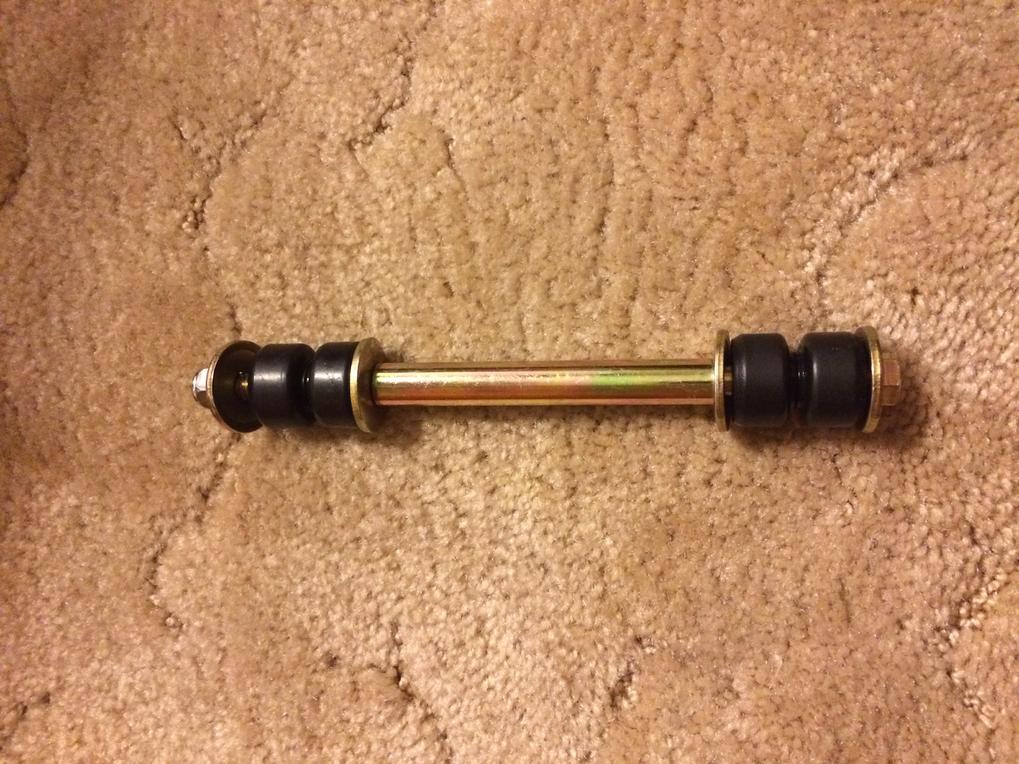

I trust everything you say as well as [MENTION=65101]BrianSD_42[/MENTION]. Are you guys just running aftermarket links or are you using the fronts for the tears or using 2nd gen links. I bought some energy suspension links but I am having a hard time trying to figure out how I'm going to mount them
I am running what I imagine are the same links you have there... Check out page 32 of my build thread... I think I made it pretty clear how I did it, and if not, I posted the link to the original "how to".

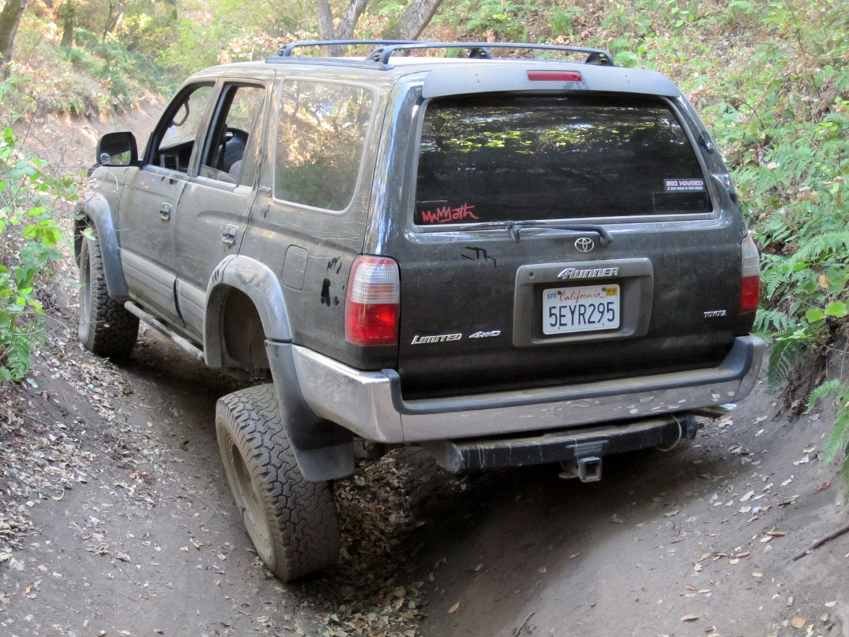

Does having the rear sway bar attached reduce travel?
I say, for all practical purposes for most trail goers the answer is no.
You can look at the many pictures I've posted here and see the full rear articulation of my suspension. In every picture the rear sway bar has been properly installed.
