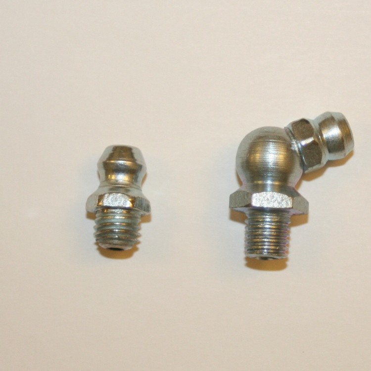

The rear bushings came in (Canadian Tire special order C$39.67) so I finished this job. Kept the stock bolts with washers and added size M8 washers (the bolt length still protrudes out the back nut.) Changed out the grease fitting for an angled one (see pic below) on the drivers side because the gas tank shield is too close to get the grease gun coupler straight on. I did the same to the front fittings so that I don't have to remove the skid plate to grease them.
Also did the rear endlinks at this time.
Overall improvement in less body roll while cornering is well worth the total cost of ~ C$93.
