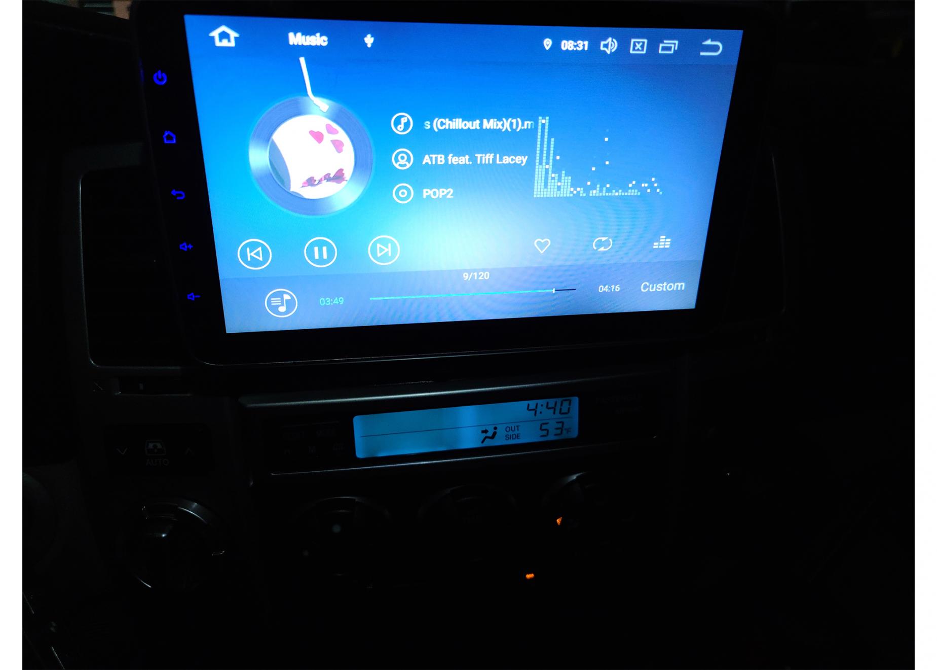

SWC doesnt work with PX5 Android Headunit (Generic Android Unit,,multiple makers)
This is the typical PX5 Android unit.
Amazon.com Page Not Found...
2005 Sports with JBL.
Everything appears to be working fine..(front camera, back camera, audio..etc..
Except for the SWC.
Unable to get the Steer wheeling function to work.
See the picture above.

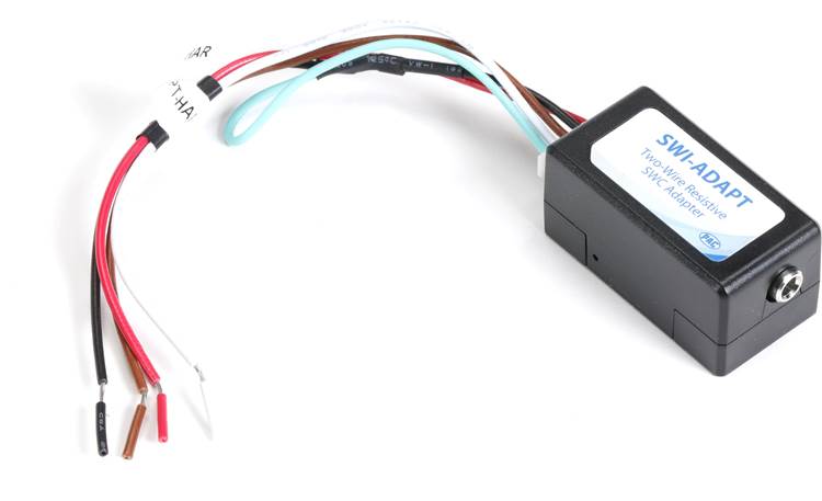

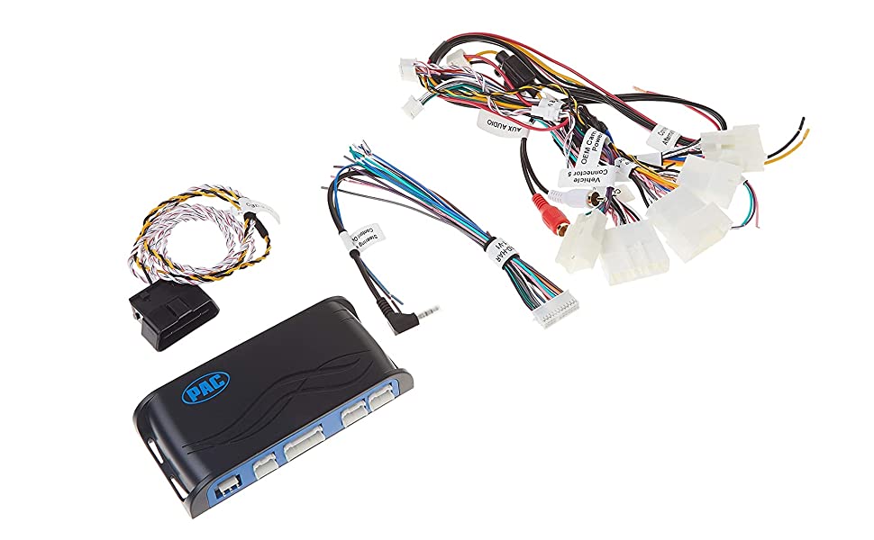

PAC RP4 TYII Steering interface.
PAC SWI ADAPTER to plug the KEY 1,KEY 2, 12V and GROUND. I connect the KEY 1 and KEY2 from the HEAD UNIT to this SWI adapter.
Using PAC RP4, I connect the 3.5mm SWC plug into the PAC SWI. This complete the connection between SWC module and Head UNIT.
I have set the PAC RP4 to "Other head unit"
It does NOT work.
