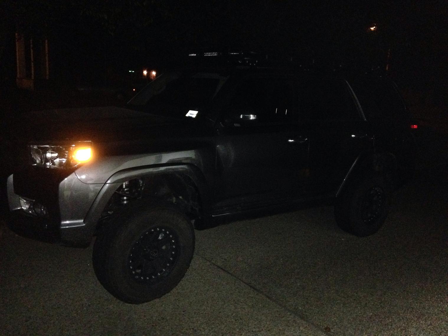

Here you can really see how I need bigger tires to fill that fender well :)
