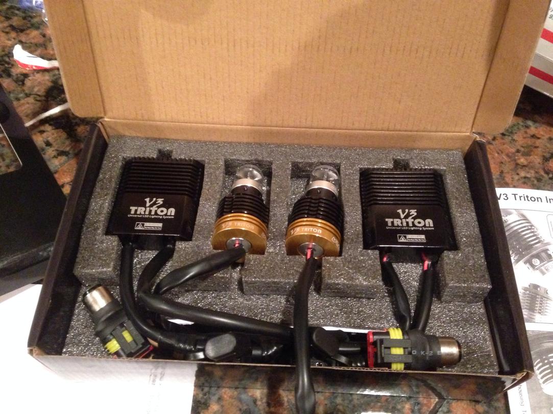

V3 Tritons...
Hahaha dude..! By the time Xmas rolls around, the only thing left on your truck that is OEM Toyota will be the badge and key!
Who's doing the install?
Okki
Now you're just showing off...
Damn...it's all gonna look fantastic when on.
