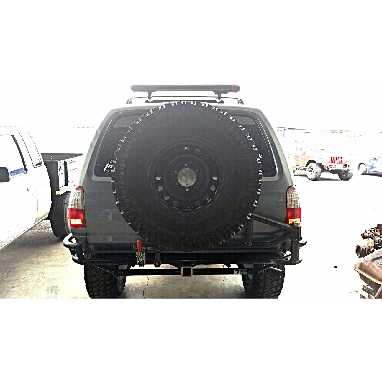

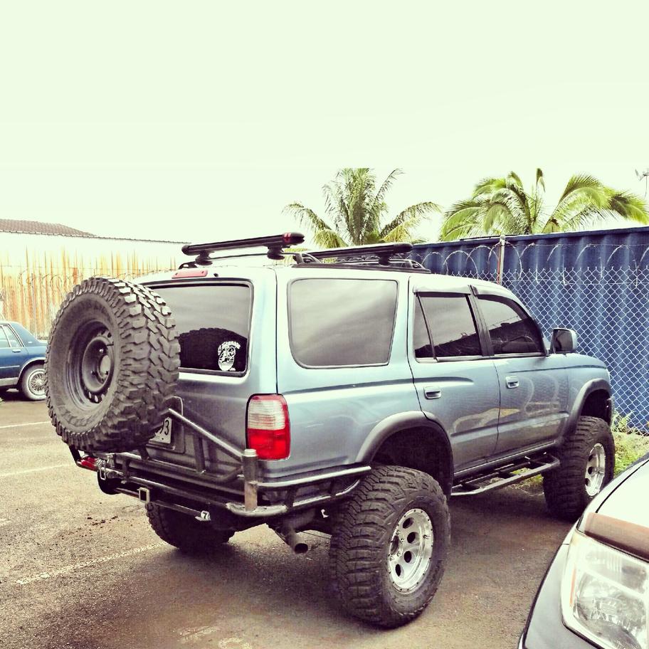

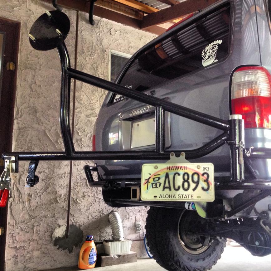

Here's mine (on the old 4Runner, with primer, before blasting and powder coat):
Here it's on the new truck, after powder coating:

That looks good. Are there bushings on the swingout hinge, or just a bolt and tabs?
It has bronze bushings. Here's the parts list from the link at expo I posted above:
McMaster Carr (McMaster-Carr)
flange sleeve bushings (2) 6338k439
1" gr 8 bolt, 6" long 91257A969
Flat washers 98023A038
Nylock 1" 97135A038
7767T811 Steel tubing, 2" OD, 1.250 ID, .375" wall thickness, 1' length
It all came to about $65 plus shipping.
I did have to hone out the tubing to get the bushings to press in - a lot of work. A lathe would have made it much easier. I plan to drill the tubing for a grease zerk but just haven't done it yet.

Good info here. I have a question about the fit of the bolt in the bushings. Is there a lot of slop between the diameter of the bolt and the inside diameter of the bushing? I know they make bolts slightly undersized than the nominal size, and shaft/bushing fits are usually very close. So how loose/tight is the fit? And does this cause any issues?
Thanks!
Thanks for all of the replies, this is exactly the discussion I needed. I see lots of good and creative work and information here.
Thanks!
The bolt fits tight in the bushings with very little play. The carrier doesn't move up and down at all (well, maybe 1/4" at the far end if I lift and push). The bushings are just a bit too large for the tubing so I had to hone out about 1/64th, which took forever since that steel is hard and I used a brake cylinder hone on a drill. In the end I sanded the outside of the bushings to take off the last little bit and pressed them in with a vise. I'd recommend sizing the inside of the tubing on a lathe if you have one - it'd be much quicker.
