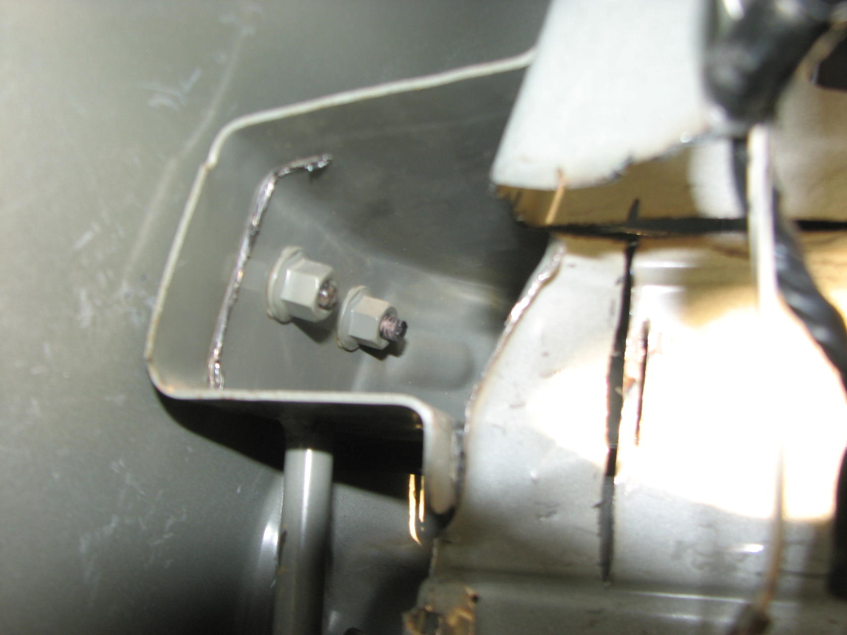

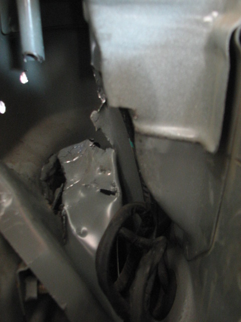

. My underneath spare caught on fire so to alleviate that danger I decided to retro fit a swing out carrier on my 91 4runner. I found a full tailgate and swing out carrier on Craigslist for $100. I am in the process of installing in the internal mounting bracket. The top part of the bracket, after a little sub frame cutting/butchering went in fine. The problem is the bottom half. My question is can I cut the dark gray hump in the second picture. It is in the way of sliding the bottom bracket into place. The sub frame I was able hack away but the darker gray will need a sawz all. :pout: is it safe to cut?

Make sure you either back up they body steel with some large metal plates or at least some large washers so the bolts don't pull thru the body.

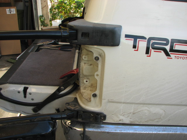

rear quater panel
this is from my existing quarter panel. It does need to be cut in order to slide the bottom bracket into posistion. There is an addiontional layer of steel that needs to be notched out. the darker gray. :lookout:
