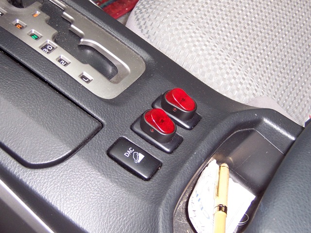

I use the blank to left of the wheel for the back up light. It's a toggle switch.

I just added some rear stealth fog lights a few days ago. I used a relay to make the lights come on when I hit reverse. I also installed a rocker switch on my dash that lets me turn on the lights anytime I want to without the car being in reverse.
Edit: I should mention that the oem rocker switches are for my emergency lights (strobes). The round rocker is about $3 from the RatShack and is what I am using for the rear fogs.

I picked up the switches and harnesses from Sparks Toyota in South Carolina. I just clipped off the end that plugged into the FJ and ran the lead wire to the lights.
Switch P/N: <a href="http://www.trdsparks.com/displayparts.php?Mdl_dtl=603&Part_cat=24&parts_id=1971">PT297-35070-AS</a>
Harness P/N: <a href="http://www.trdsparks.com/displayparts.php?Mdl_dtl=603&Part_cat=24&parts_id=1972
The 2 switches are hooked up to 4 lights mounted in the front. I haven't found a mounting solution for the rear i like yet. With my luck if i mount them on the bottom of my bumper, they'll get torn off!!
