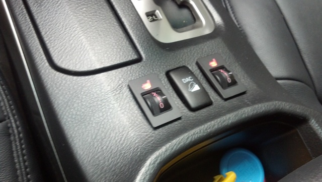

Where'd you put the switches? In the two blanks in the center console? Do they look OEM?
I'm still on a search for the correct trim piece so I can put the switches in the 'stock' location
Glad to know it fits fine!
I moved the one switch over. Come to think of it, mine are slightly different.
Those look good! I'd like to save those blanks for more projects, but if I can't find a part number to order the correct trim piece, I might just move the DAC button over.
How hard was the DAC button to move over?
It's easy to move the switch. Just looks better moved for looks.

This is the kit I bought. In the pic its lit blue, however, mine lights red. They must of changed it. And never updated the pic. I was happy with the change, since the red blends perfect with the stock lighting. You just need to file the stock opening just ever so slight. Took 30 seconds.
