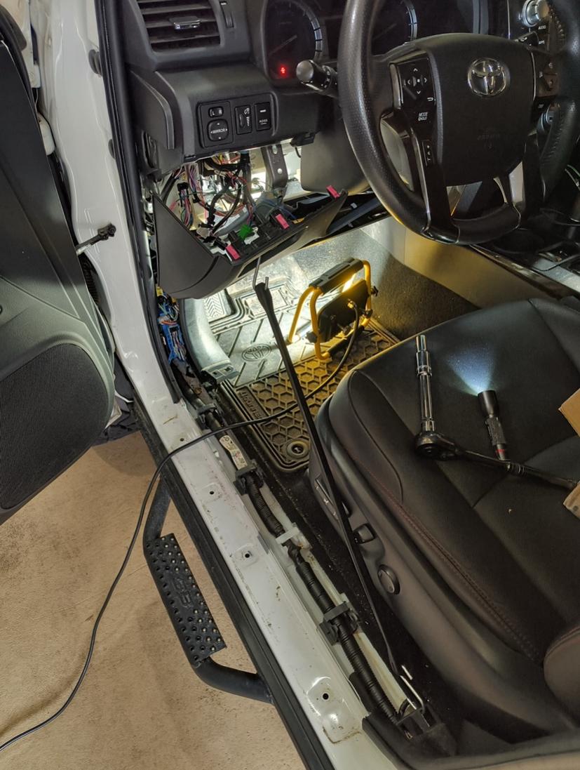

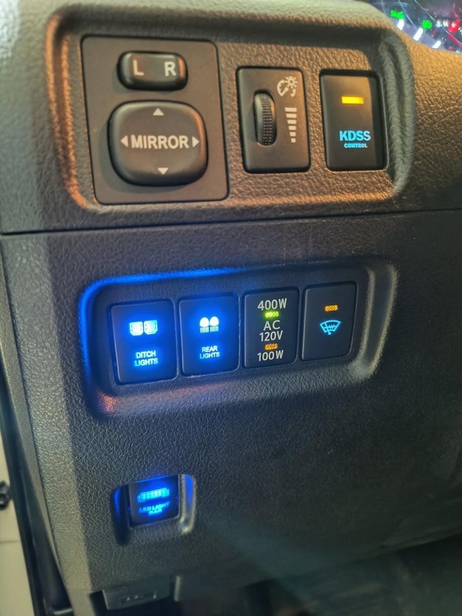

Hey OP
I’ve done this exact task on my 2016, a number of times.
I wouldn’t recommend going for it without watching YouTube videos first. You gotta YouTube these things sir. There’s good advice in the answers here, but there’s more to it, don’t believe - look at my photos. don’t be that guy who busts clips forever :)
Goodluck

i usually just pull the whole dash section (that contains those switches) out/down and squeeze my hand in there and the blanks have tabs top and bottom you squeeze, push the blank out. pretty simple. I dont mess with the panel above the switches. prolly easier to pull out the top panel though.
