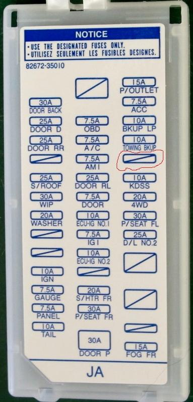

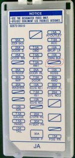

I have used the unused blanks on the dash as well and then tap into the unused switched power source on the fuse box.
