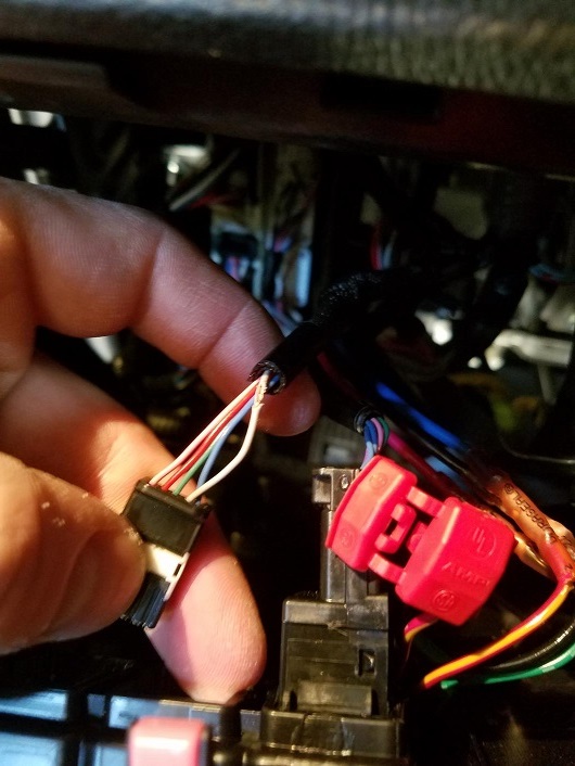

Can anyone verify which wire is the hot dash light wire? I have an auxiliary switch for my LED light bar that has 4 wires on the back. Already tried the gray wire, hence the stripped insulation.

Would help tremendously if we knew what connector you were holding.
Also, why are you stripping wires?
To test, you could just touch the connectors on the end of the plug, then make your connection!

Thanks guys. Got it wired right with your tips

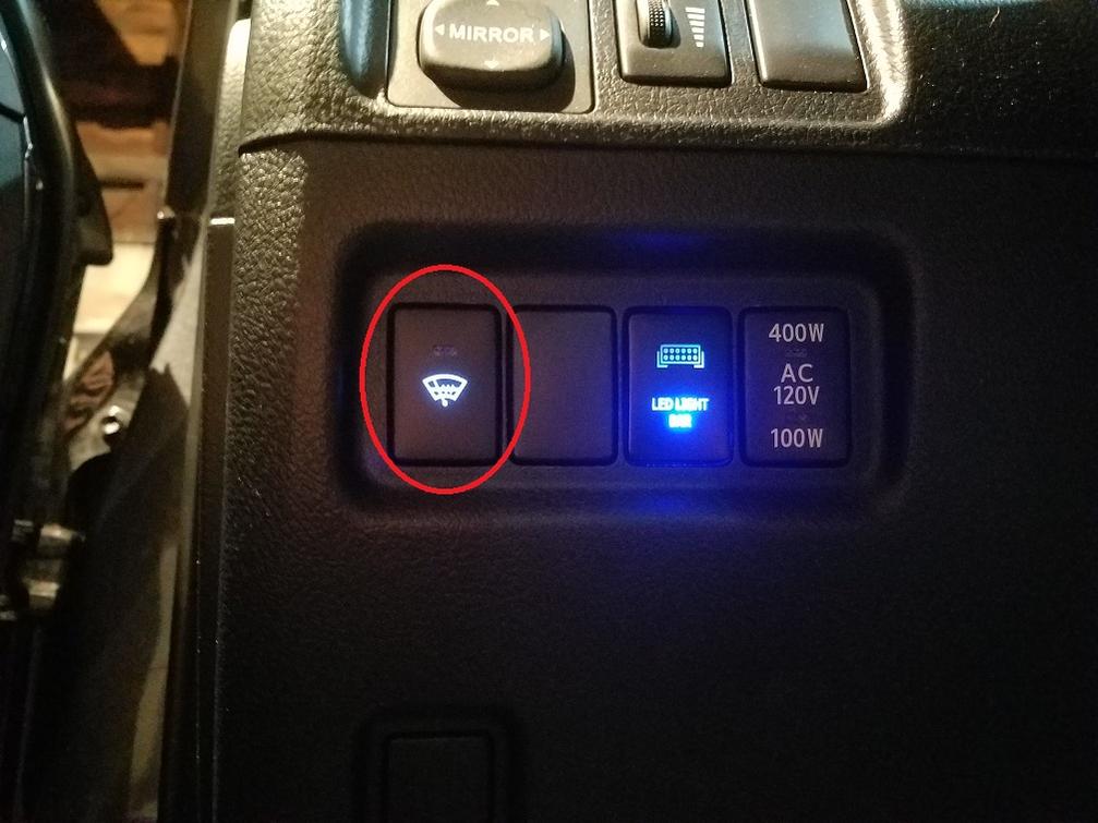

[MENTION=65614]Antman[/MENTION] its the defroster, circled in the pic. You were right, it was the green wire.
[MENTION=65614]Saker[/MENTION] Because I'm a dumbass and didn't think of that first. I tried the green wire first per Antman's suggestion and bingo.
Clearly this is my first time working with aux vehicle lighting and switches. I found a lot of good posts via google Like Antman's post from a while back instructing the OP to pull the lower dash off... way easier than reaching your hand behind the dash and getting cut up. Also Saker it was your grill light bar thread that gave me the idea to tap into the defrost cables for back lighting.
Now all I have to do is tie the light bar in to the high beams so I can turn them on an off from the stock switch.
