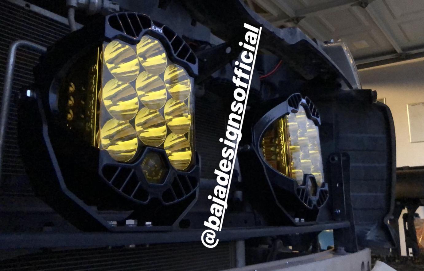

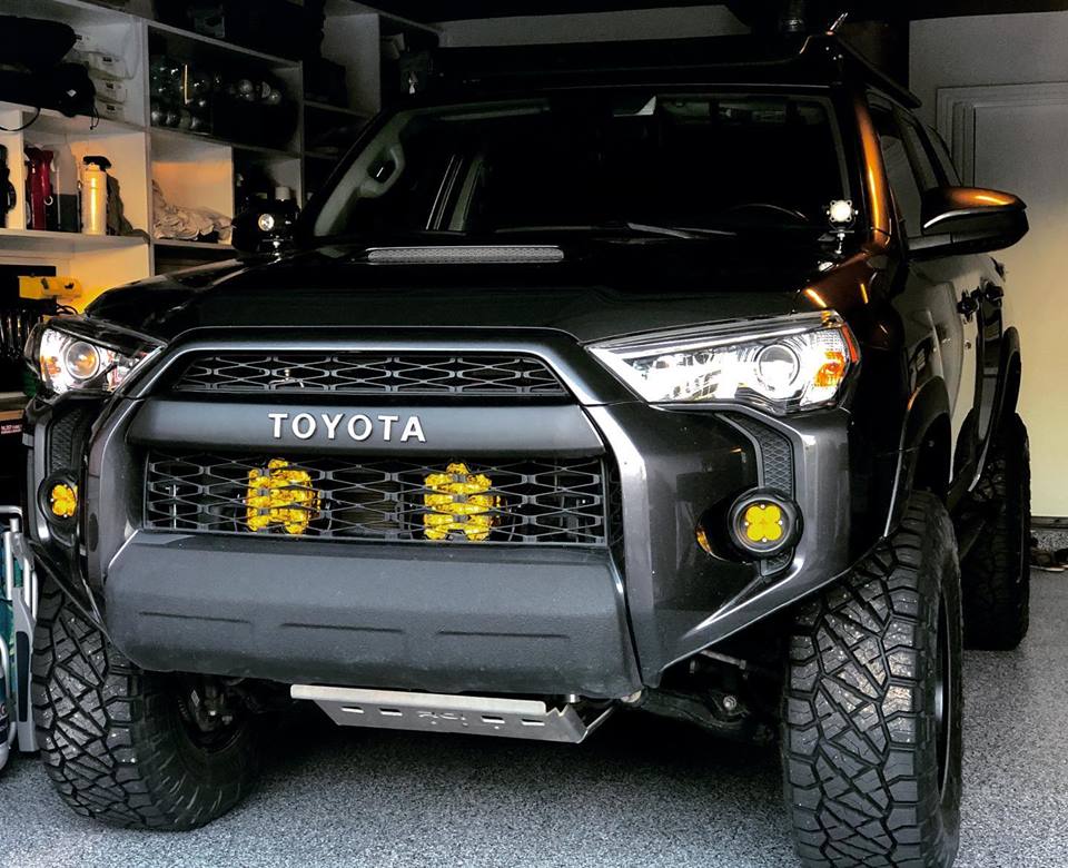

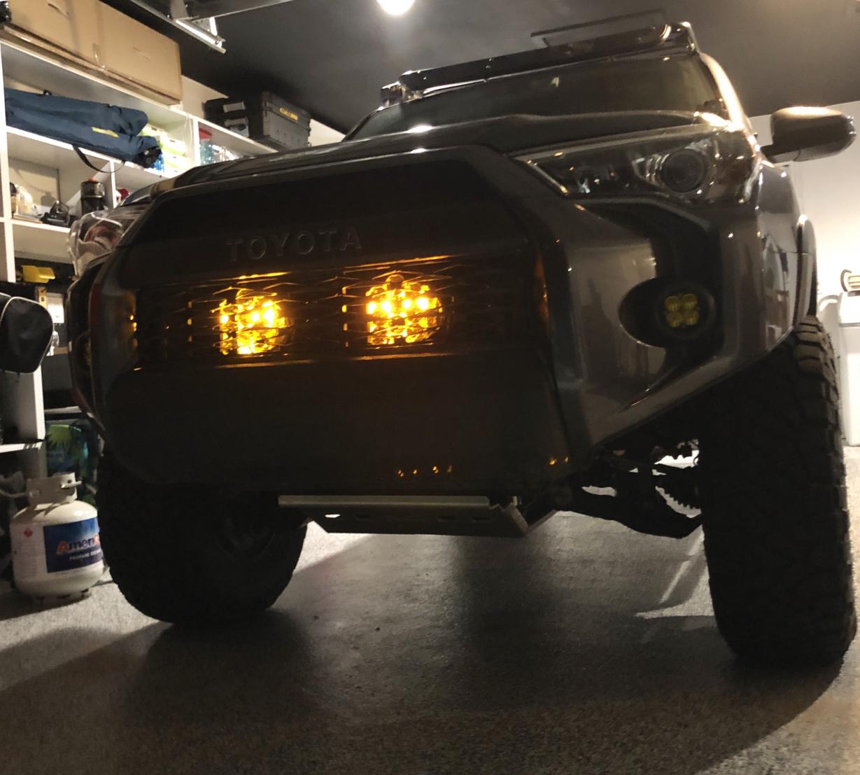

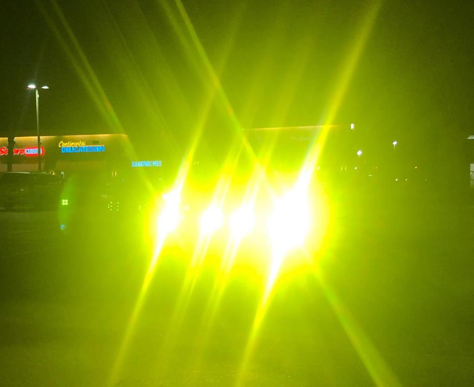

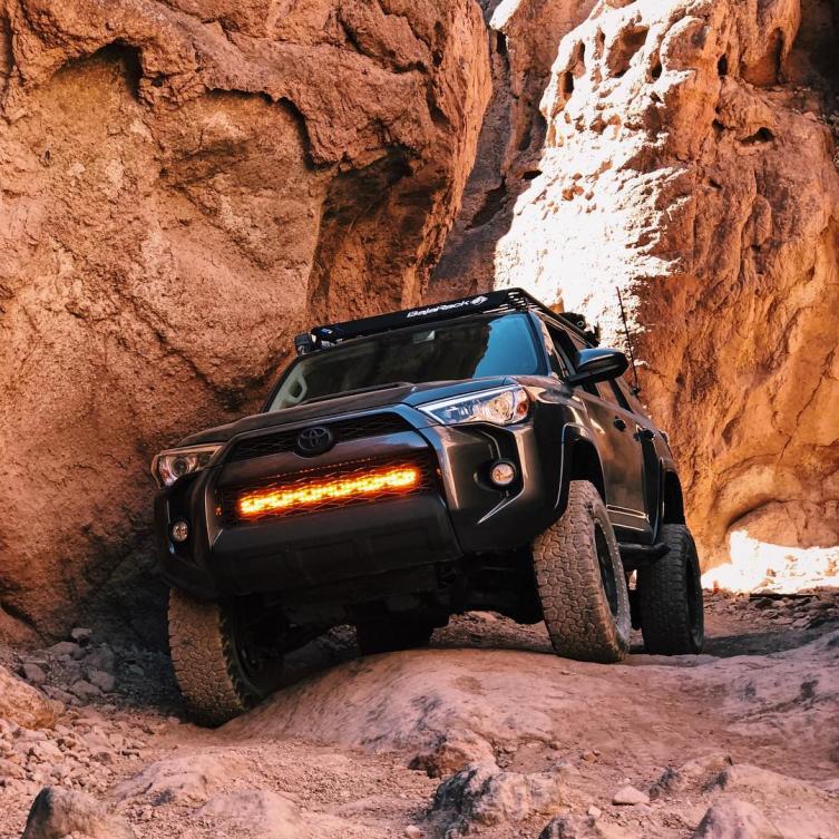

2/21 update. Swapped out my lights up front with Baja Designs' goods.
I built a horizontal bracket behind the grill using 1/8 steel and some L-brackets. Measured twice, drilled my holes and the lights line-up perfect behind the grill. I've gotta take the bumper off to do some adjusting of the angle but damn these lights have some serious distance to them. I wasn't able to find too many personal reviews of the LP9 Pro's online so I'll put up a post on my IG as I break them in and get some experience with them.
Baja Designs LP9 PRO (AMBER, SPOT)
Baja Designs Squadron Sport (AMBER, WC)
Baja Designs S2 Amber, Driving (rear chase)

:thumb3:
super jelly of those LP9's. Straight baller status.
Theyre worth every penny. Between the Squadrons as my Wide-cornerings and the LP9s that light up everything within a mile, I have no need for anything else up front. I will take off the KC flex ditchlights shortly to free up space on my switchboard because they are completely useless now haaha

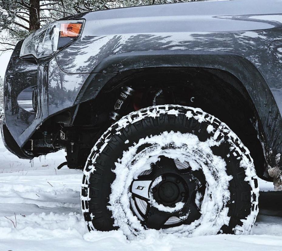

hahahah sorry man been tied up with work. I just measured it:
F: 24"
R: 25.5"
Another update 2/26:

Damn... I have 2" Icon Lift Springs in the rear and 1 3/4" threads showing on my front Icon 2.5 non-resi coilovers with 650 springs and my hub (center of centercap) to fender measurements are both 23.5" front and rear. I have the measurements the same since I am going to add more weight to the front next week, which should give me a very slight rake which I am looking for. With that said, you are way higher than I am for sure! How many threads are showing on your front coilovers?

im on 5100 with ome springs. Last night was 24F 25R. Was shooting for relatively the same if not a smidge higher in rear like our boy here.
could be wrong 1 3/4" of thread showing arent you allowed up to 2something? so maybe crank them higher? have you adjusted them from what icon sent them to you at?

Keep a sharp eye on your CV angles if you are 24 in the front.
Some rigs can handle it better than others. Mine were angry.
