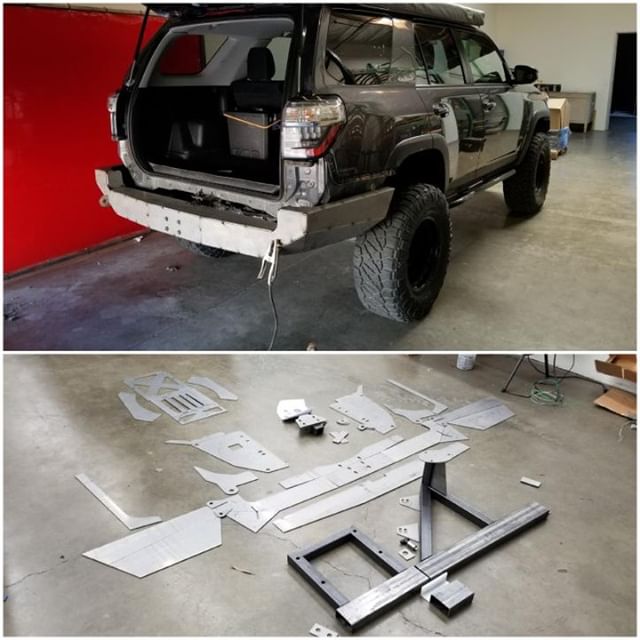

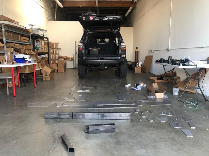

Update 3/11:

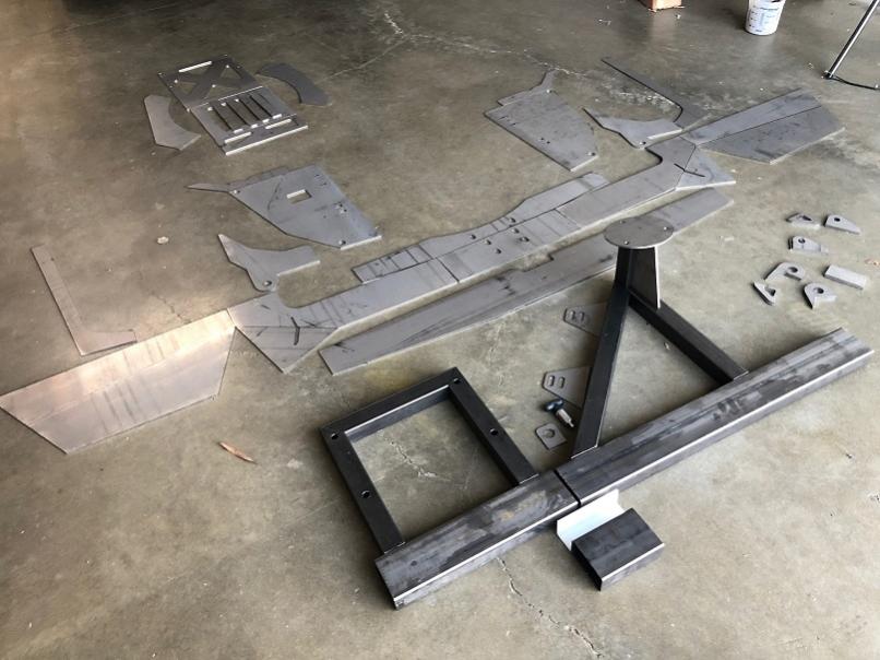

The coastal offroad bumper has arrived. Should be able to get it welded up and onto the vehicle by end of the week.
Getting ready for some welding, chopping, grinding, painting, drilling, cutting, whatever other mayhem you want to toss in it...

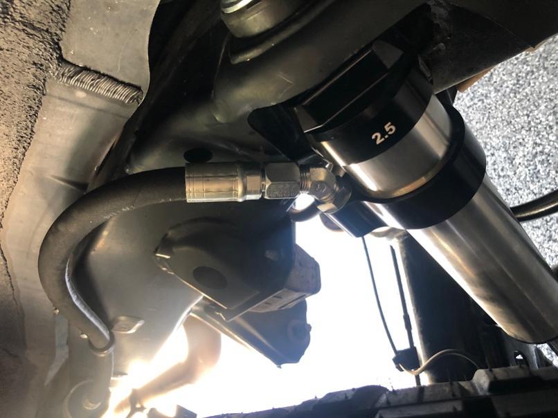

Also the rears got 2.5 ICONs now...

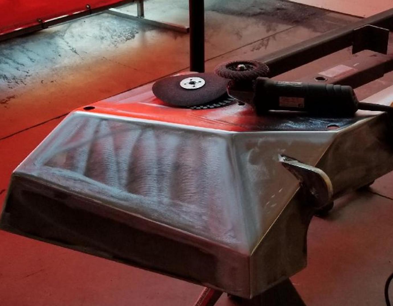

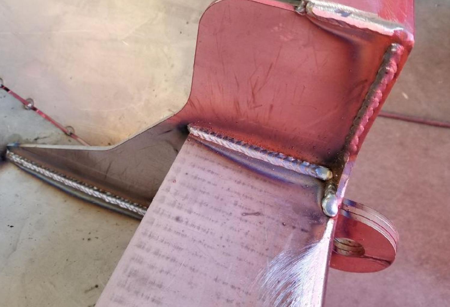

3/18 UPDATE:
Bumper's still getting buttoned up. Lots of time going into it to make it a piece of art:
-All the piece's edges are beveled to make it fit perfect prior to welding
-The recovery points are now 9/16 thick by stacking a few more pieces of steel
-Radius edges. Smoothing out all the corners without cutting too much into the material.
The swing arms should be getting slapped on tomorrow hopefully. As you may notice - i do have a Baja ladder on the driver's side. We are looking at notching to make the swing fit with the ladder in place. Wish me luck hahaha.
