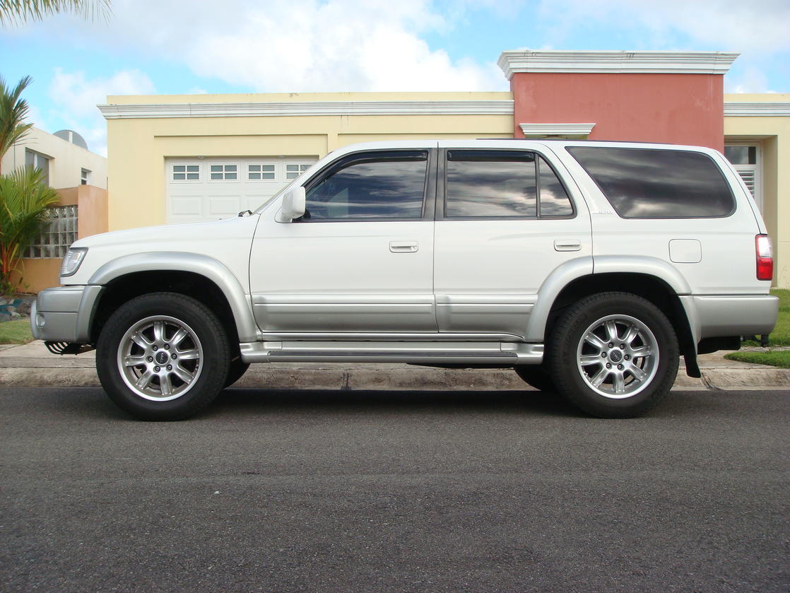

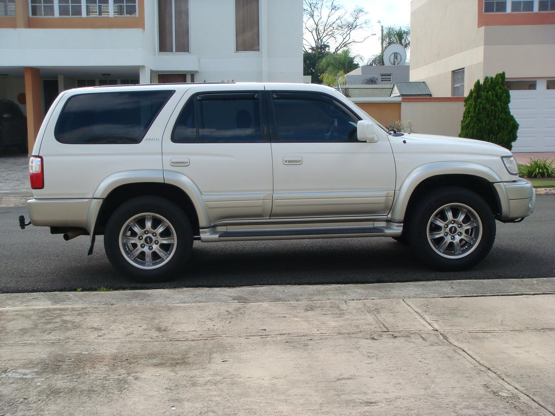

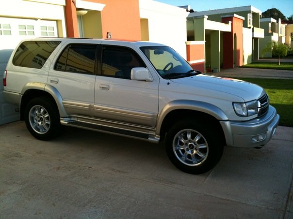

These are the wheels my T4R has. I will take a picture from the side so you can compare front and rear height.

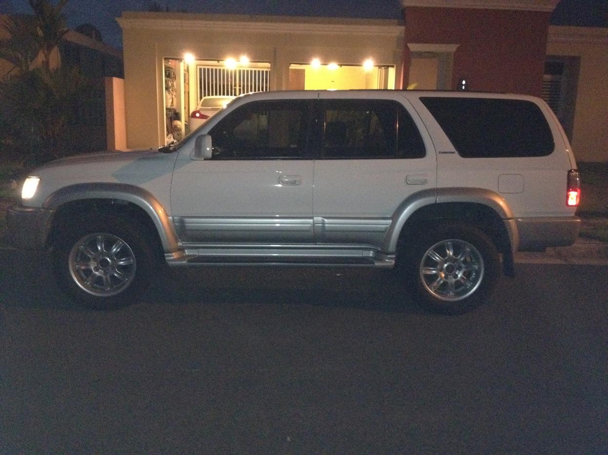

Is that a current picture? It looks like your riding maybe just a little low(may not be low at all) but it doesn't seem like you should be bottoming out.
Wheels are 18" x 9", 10mm offset, each one weighs 35 lbs. They're wrapped in Michellin's P275/55R18. And yes, it is a recent picture. Coils don't even have a year running in my runner.
You went from a 16" wheel to an 18" wheel, while retaining roughly the same outer diameter of the tire, meaning you lost about 2" of sidewall, as you gained 2" of wheel. That right there is likley why the ride feels harsher than before, you have way less sidewall to soak up the imperfections in the road.

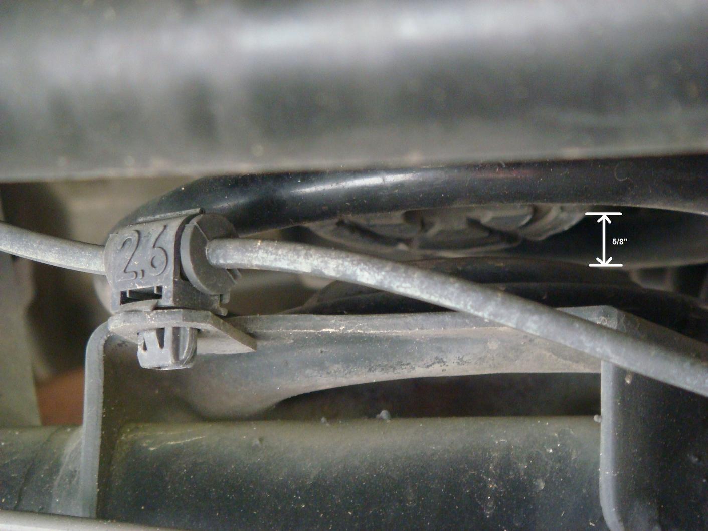

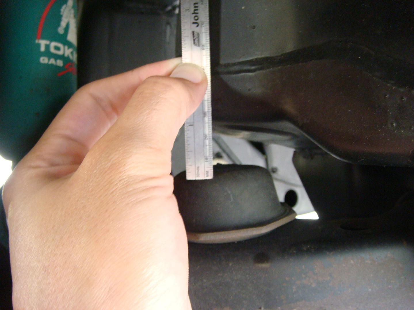

When taking the pictures, I noticed that it has lost some lift on the rear, I remember seeing it dropped in the front. Those 4 coils are OEM's and are not even a year old!
Regarding clearances, see them for yourselves. Barely an inch on the front, just between the A arm stop and the chassis. On the rear, 5/8" or .0625", not even an inch. That's the reason of the hammering I feel on the rear suspension; the differential is bouncing all the time!
Was planning to at least install spacers on the rear to get more clearance and then see what can I do on the front.

In the back. But should be related to that 5/8" small clearance. As said before, I feel the differential hitting the stops and going back again, like bouncing.
Will get at least 1" spacers and then see the outcome.

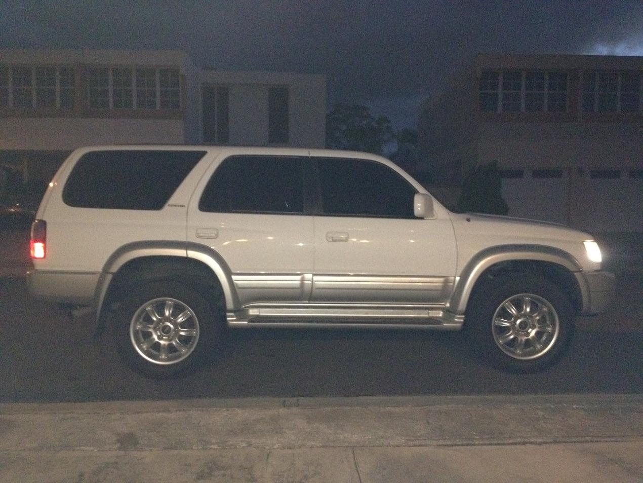

Although it seems dropped in the back, at least for me, it is actually leveled. Same height between the top of the 4 tires and fenders moldings and ground to running boards.
Just added new Daystar 1.5" spacers to the rear coils. It's like magic! No more harshness at least on the back, no differential bouncing and hitting the rubber stops! It now moves a lot softer (I am not into offroad and was looking to get a better ride on normal road). Check the new pics. Now planning to make a small 1" lift in the front as it looks like a Funny car :lol:
Will let the suspension to settle and then see the way to go.
