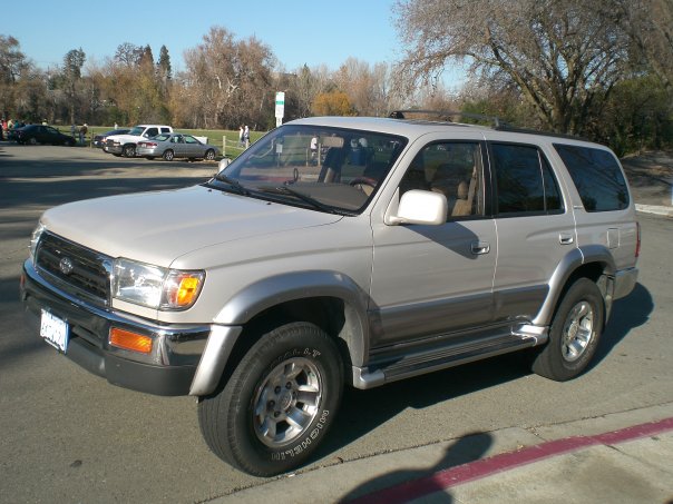

Little history, got the 4runner when i first got my license it is my first car/truck, i still drive it today. first thing that was really bought and owned by me. It was mint when i first picked it up.
1998 limited edition 130k
