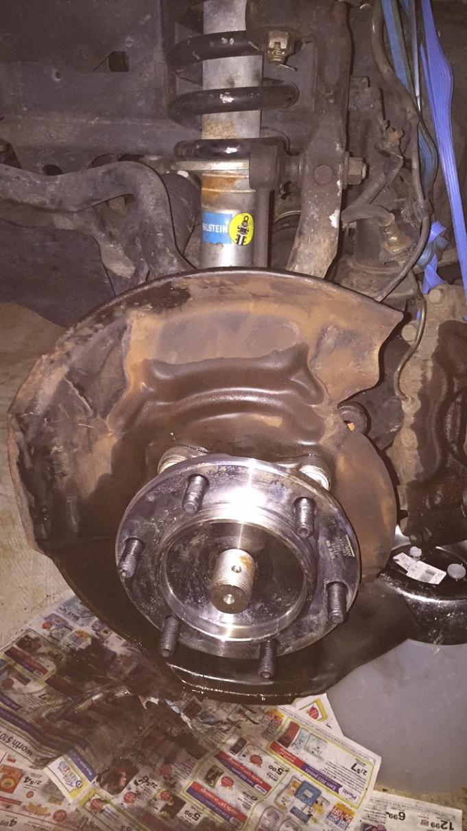

I decided it was time to ditch the daystar spacers and get some 5100's. While I was in there I decided to get some upper control arms since mine had a TON of play in them. The control arms were from a newer 4runner from a member on here locally who hooked me up. On the front I have the 5100 set at 1.75 and have tacoma TRD springs which yield about 1-1.5 lift. I'm sitting a little bit higher than with the daystar spacers on. For the rear i have the tacoma 5100 which is a bit longer than the 4runner i believe. I also changed the eye bushings with energy suspension bushings for it to be able to fit on the 4runner.
The install was not bad and I was able to do it mostly on my own. The top bolt on the rear shocks would not budge so I had to run to the store and buy a sawzall as my grinder wasnt doing anything!
<a href="http://s108.photobucket.com/user/crx_skater/media/IMG_2717_zpsgysb0t3b.jpg.html" target="_blank"><img src="http://i108.photobucket.com/albums/n30/crx_skater/IMG_2717_zpsgysb0t3b.jpg" border="0" alt=" photo IMG_2717_zpsgysb0t3b.jpg"/></a>
The 4runner rides so smooth now, I love it. I will have to get pics of it with the 5100 installed. I also need to go get an alignment.
