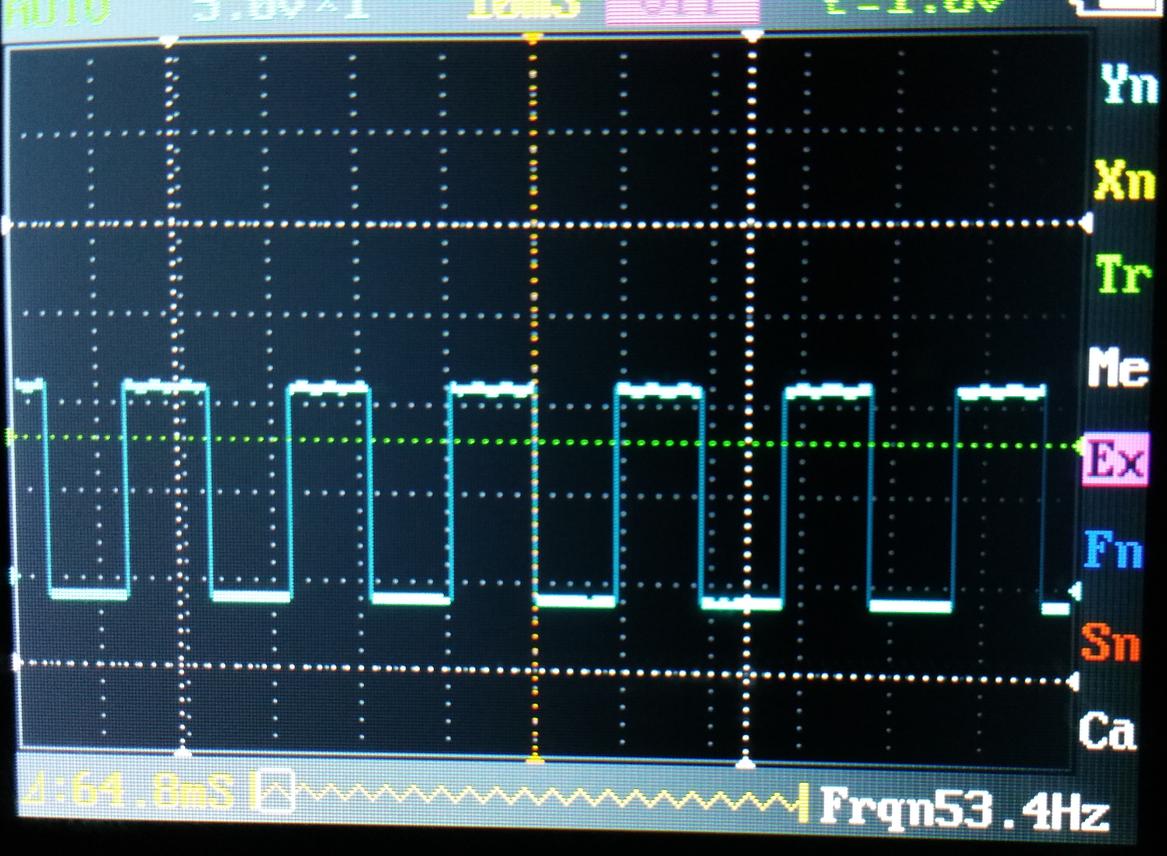

Last night I put an oscilloscope on the C9-6 pin for the tachometer per the SM. I have never used an oscilloscope before so Im not sure about what I'm seeing. It looks like the waveform is correct. I don't know if horizontal shift makes a difference but I believe it does. If that is the case, the pattern is correct but is shifted. Again I've never used a scope before so hopefully someone can clarify this for me.
Tested @ 5v/10ms

Pulled the dome fuse for a while. I reinserted it then preformed the calibration on the combination meter. No luck, I'm still having the same issues.
I'm starting to think this is a lost cause and I should just fork over for a new/used cluster.
