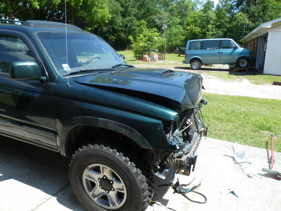

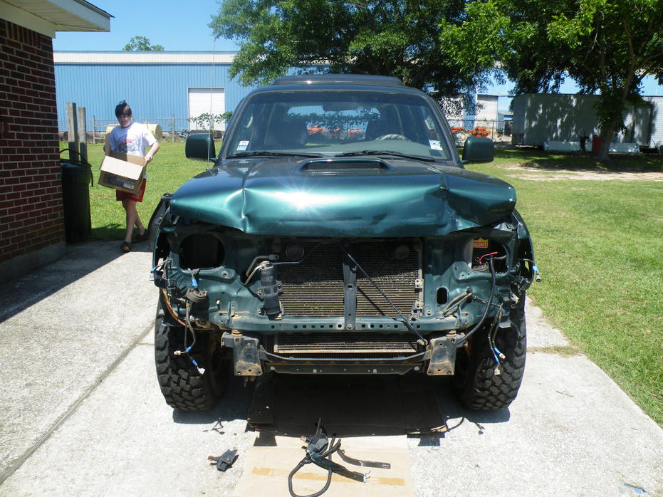

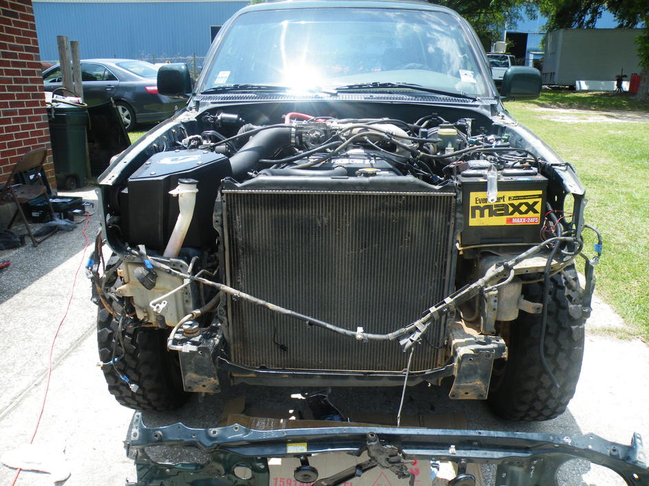

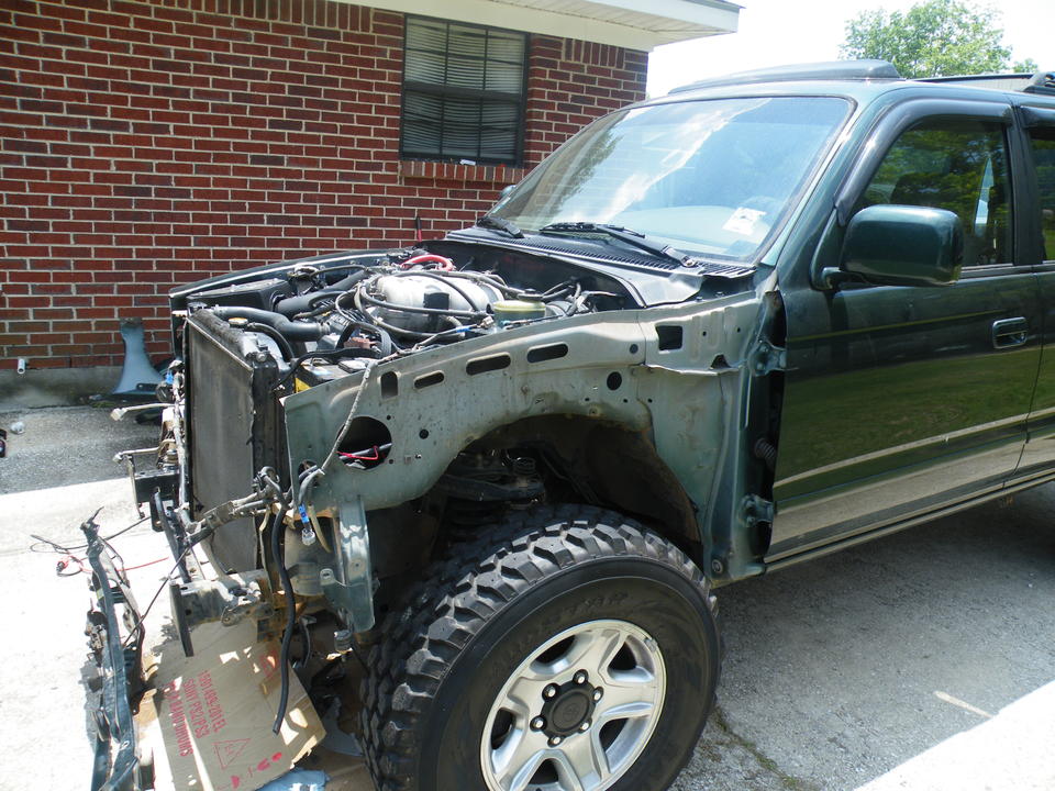

Well, I think we have removed all the damaged parts and are now left with a naked front end. Not a whole lot left, which is why I'm considering the Tacoma front end conversion. If we gotta replace everything, why not try something a little different, right?
Before I go ordering a new core support, anyone know if the Tacoma support will match up with the 4runner body mount locations on the frame, and the inner fender liners (aprons)? And 80yota, did the Taco hood hinges bolt on in the stock 4runner locations?
Pics later this evening if I get a chance. Thanks.
Travis

And here's whats left after all the damaged parts have been removed:

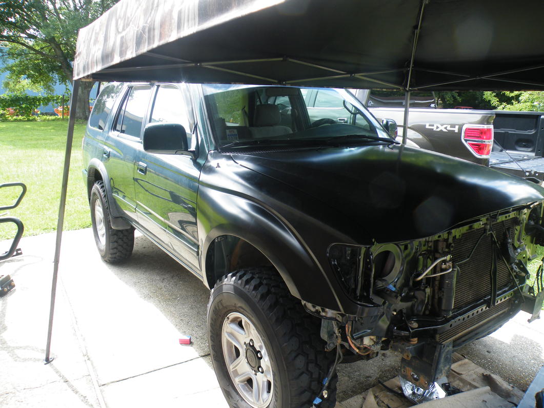

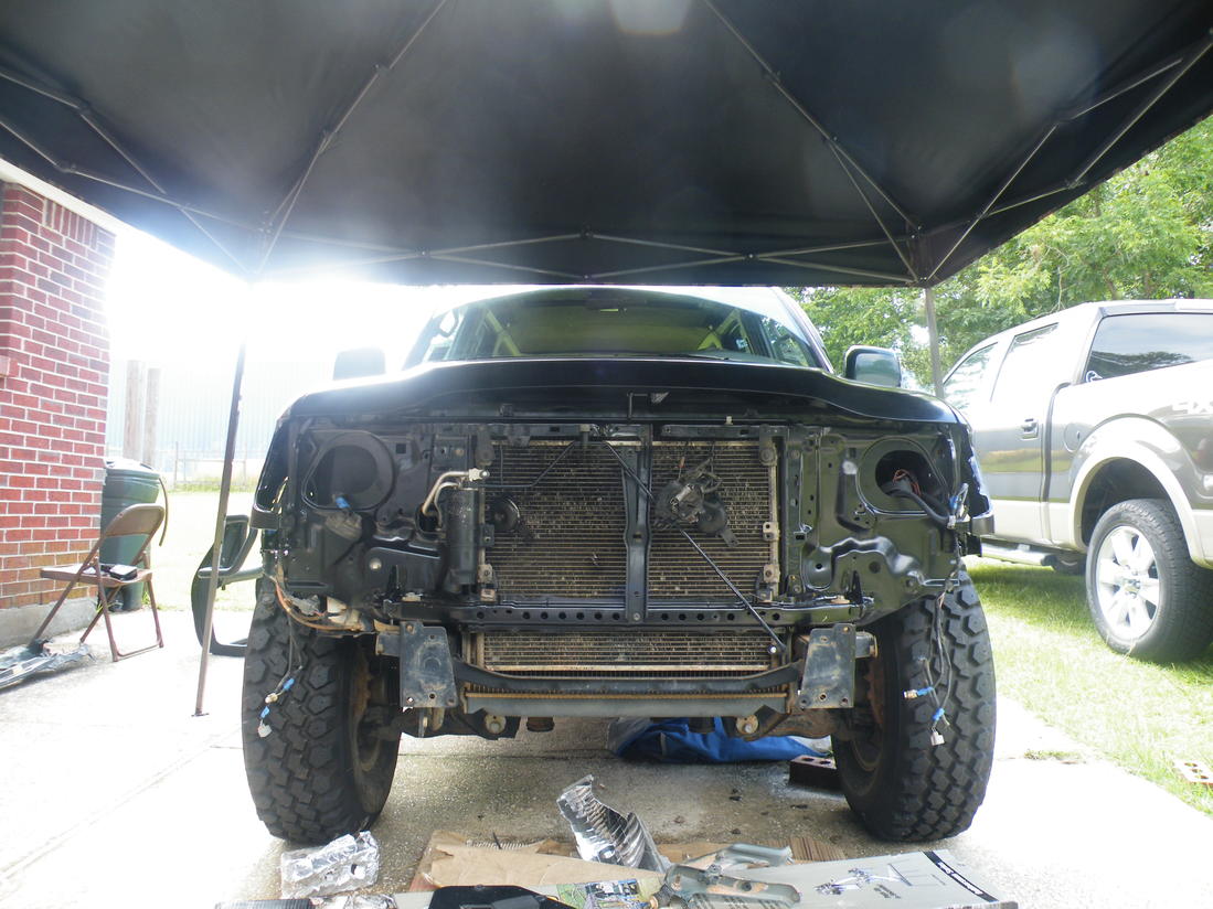

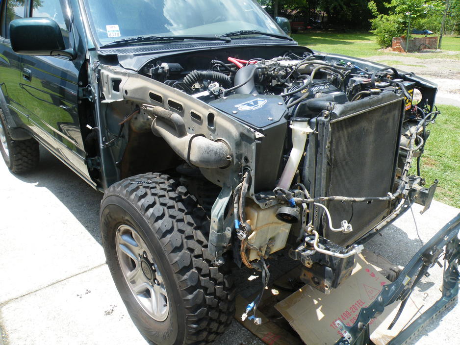

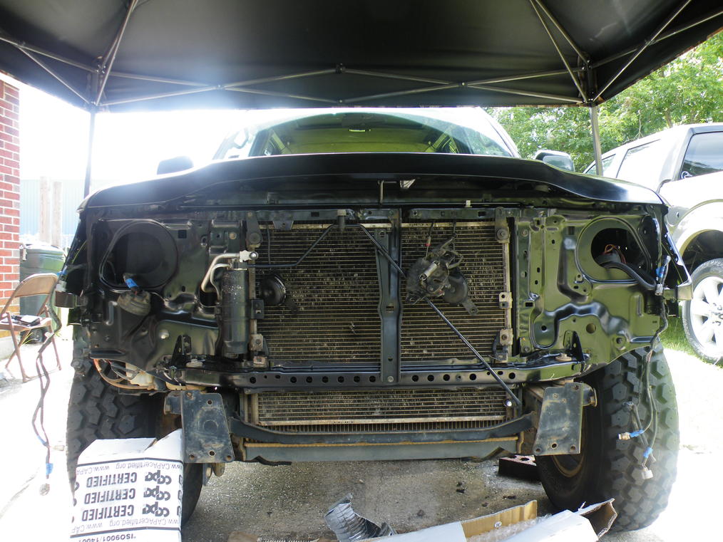

So it's been a while, but the repair/conversion is under way. First order of business was to strip it down and remove all the accident damage, which really left us with a blank slate. Had to drill out the spot welds that hold on the 4Runner core support.
First was installation of a new '02 Taco radiator support assembly. It fits almost perfectly. The old 4R inner fender aprons hang about 1/4 inch low in the front but its not a problem.

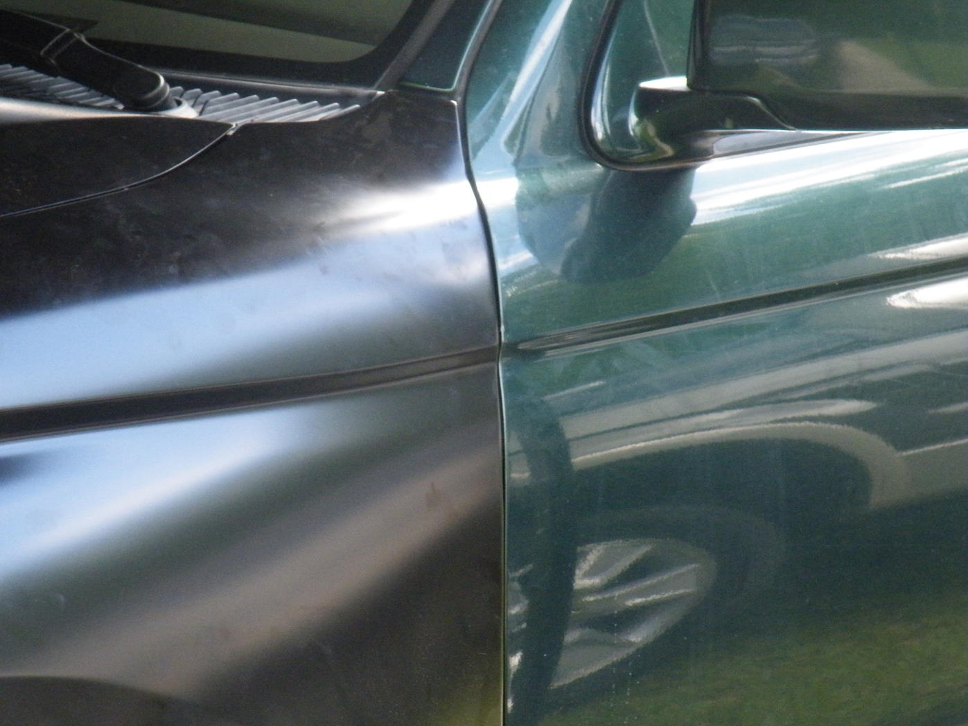

So far we've installed a new '02 Taco hood and hinges, and the new '02 Taco fenders. We won't know until everything is aligned and tightened down whether or not the 4R hood latch assembly will work, but it appears it might. The alignment of all the parts is kind of tedious, but this thing was slammed pretty hard into another car, so thats to be expected.
Next up will be the grille and headlight/corner light assemblies. Then the final touch.............drumroll please.............................Shrockworks pre-runner front bumper (if the kid keeps my lawn looking right and the cars washed/room clean......) More pics next time we add parts.
By the way, I think we're gonna paint the whole truck when we're done. BLACK should look NASTY!!!!

The Taco core support went on without a hitch. Two big bolts at the bottom body mount location, and so far, all the a/c tubing, wiring harness, etc.. all fit and clip into the new support in more or less factory holes. I had to drill out the spot welds holding the core suppt to the inner fender aprons behind where the headlights are. I think about 8 spots on each side. We havent re-attached anything where the spot welds were yet. The plan is to get everything lined up with the new parts on and shoot some self tapping screws in theere while holding it in place. Then replace the screws one at a time with rivets, and then maybe have my mech throw in a couple tack welds. I really want to wait on that though till we get the grille in and really make sure we've got all the gaps lined up right. We're going with the chrome grille with black inserts, and found some black/clear euro projector headlight/corner lights, and are thinking black paint with max tint on the windows.
Opinions?
Oh, Toyota parts would probably fit better without so much adjustment, but are VERY pricey. We're using new replacement CAPA certified parts from Keystone and will have about $900 in parts by the time we're done. It really is a simple bolt on mod. Hopefully the Taco headlights will plug and platy with the 4R wiring harness without problems.
