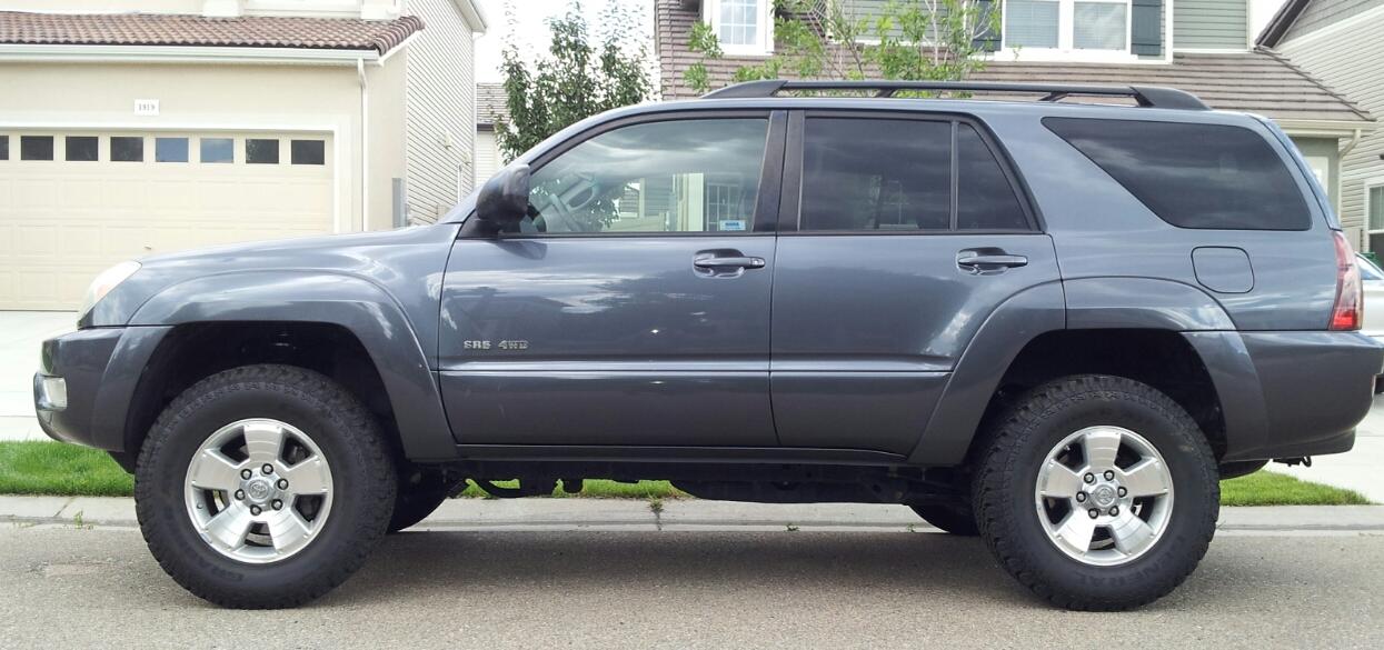

Thanks to Cygan, this is now complete....
2005 SR5 V6.....General Grabber AT2s 265/70/75.....2014 TRD OR Shocks and Springs with Toytec 1/2 inch spacer
Driver and Passenger Front: 21 3/4 Center Cap to Fender
Driver and Passenger Rear: 22 1/2 Center Cap to Fender
Driver and Passenger Front: 37 Ground to Fender
Drived and Passenger Rear: 37 Ground to Fender
Moog FJ Rear Springs.... I had to cut about an inch off so they would seat properly.

Like it! Turned out really good. I've been trying to figure out which rears to go with. Looks like the moogs can still be on my short list.
I did the same swap on mine just over a week ago and used OEM FJ rear springs. Sometime soon I need to get some pictures.
