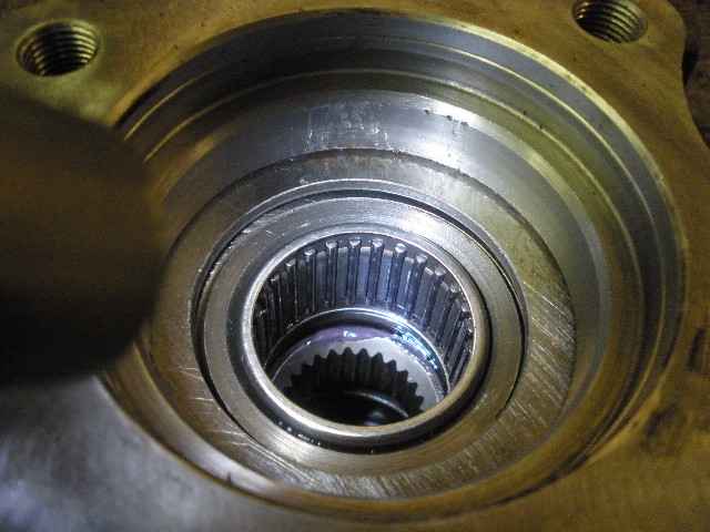

Do you have a picture of these needle bearings?
Sure do, pulled this off of 4x4wire
That is awesome. It is a bearing inside a bearing. So, another reason for not having a diff drop, Those little needle bearings spin all the time and if the oil level is not at the level, then they will run dry.

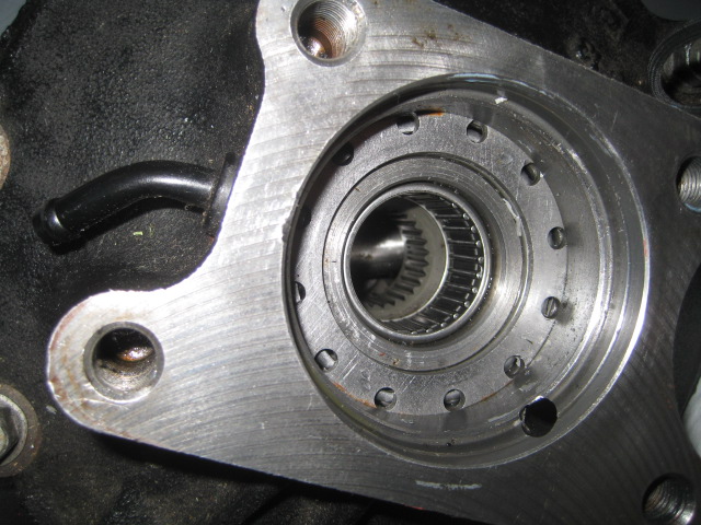

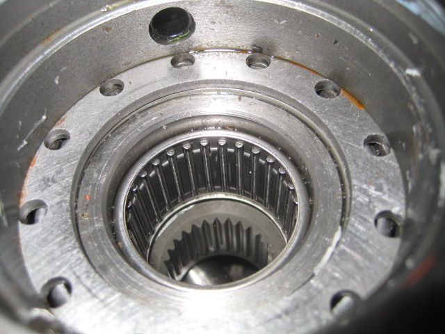

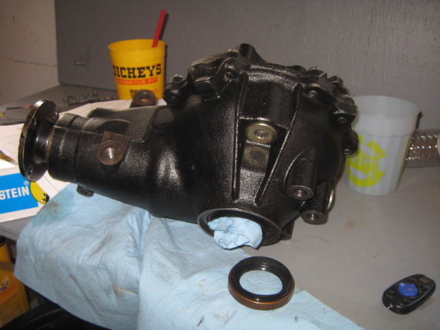

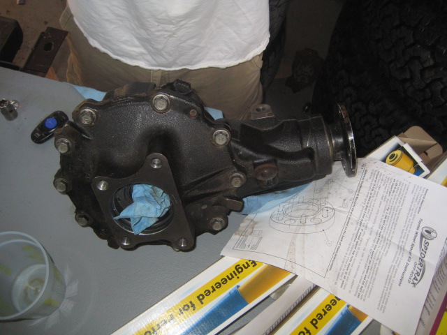

OK, so I have needle bearings and a vacuum port. I don't see any place for an electrical connection of any kind. Does this mean this diff is 100% compatible, no changes needed?
