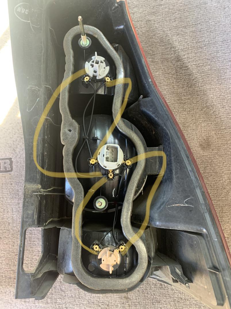

I’ve been on here for days trying to find a solution to my problem and have tried every solution it seems. Both of my tail lights were cracked or shattered so I just replaced them with a standard replacement I found on eBay. The brake lights work but my turn signal and reverse lights don’t work. I’ve also discovered that my rear wiper no longer works but my rear window rolls down and up just fine. I’ve gone through all of my fuses and have used a voltage tester that shows no power to only the turn signal and reverse lights on side. I put my old tail lights back in thinking I got a bad set and the same problem occurs. Anyone have any suggestions?

make sure to twist the socket in place otherwise no turn signal or reverse light even though the brake light works. twisting the socket grounds the other 2 bulb connections.
also rear wiper will only work if rear window is completely rolled up.
wanted to clarify that its the main socket (middle) / plug that needs to be properly seated, twisted and contacts properly lined up. this exact problem pops up at least once a month here.
you can see below how the other 2 bulb connections are powered via the main socket. so neither turn signal nor reverse light works if full contact isn't made by twisting socket properly. its harder twist than many realize.
have also seen bad wires and terminals in replacement lights. fix is to swap over the wires and terminals from the original.

I’m an idiot. That’s exactly what it was. I didn’t twist the middle bulbs back into the socket, the final step. To think of all the time I wasted (but the Bud Light made it worth it) when it was staring right at me the whole time.
